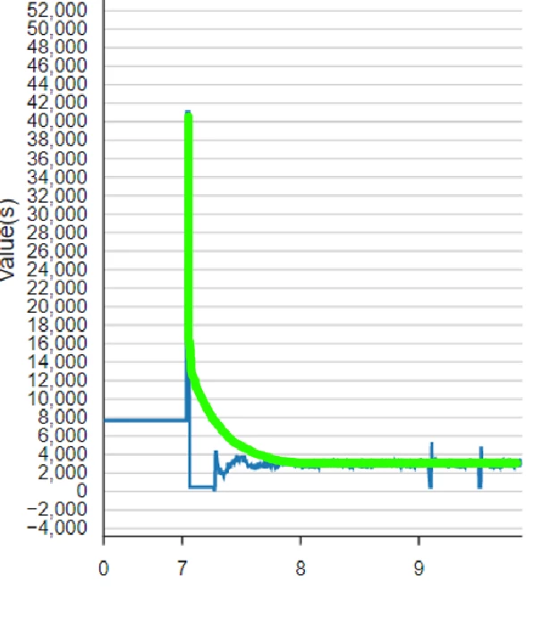

I am making a BLDC motor controller using STM32G030C8t6. This microcontroller has a hall sensor sensing capability known as ‘Hall Sensor Mode / XOR Mode’. This generates an interrupt when any one of the three channels toggle. We are taking the timer period between this interrupts.
This period value is used for the calculation of SVPWM (Space Vector Pulse Width Modulation). Using this value, we are calculating the angle within sector. While debugging, we found that the motor vibrates slightly during the motor startup, So we are getting improper period values.
The blue line is the period value, and green is how it should have looked according to motor speed. As in this image, due to vibrations during the initial stage, we get multiple interrupts, this messing up the period values.
This is the part of code where we are measuring the period value.

The following function shows the implementation of the SVPWM calculation.

Sorry for the bad composition of the earlier post. I am making a custom motor control program.
The problem I am facing is that due to the motor vibration at start, hall interrupts are generated in quick successions. So, the period value is very low. We are calculating the electrical angle based on this period value, but since it is wrong, the whole SVPWM calculation is getting messed up.
So, when period value is not correct, how should I calculate electrical angle?

I faced similar issues very early on and it was due to noise in the hall sensor signal lines. Probe the MCU Pin nodes, especially during runtime if you see fluctuation in the signal crossing 1/2Vcc it could be triggering "HALL" Timer Interrupts. Use a good filter network. May be even use a schmitt trigger.
I also faced similar startup issues when I had a motor connected to load with high amount of mechanical backlash.
I had to rewrite the rotor position feedback logic, which was intense.....
Good Luck.

I have added RC filter on the hall signal lines, and have tested them on DSO, there is no noise present on the signals which could cause multiple interrupts in my case.
