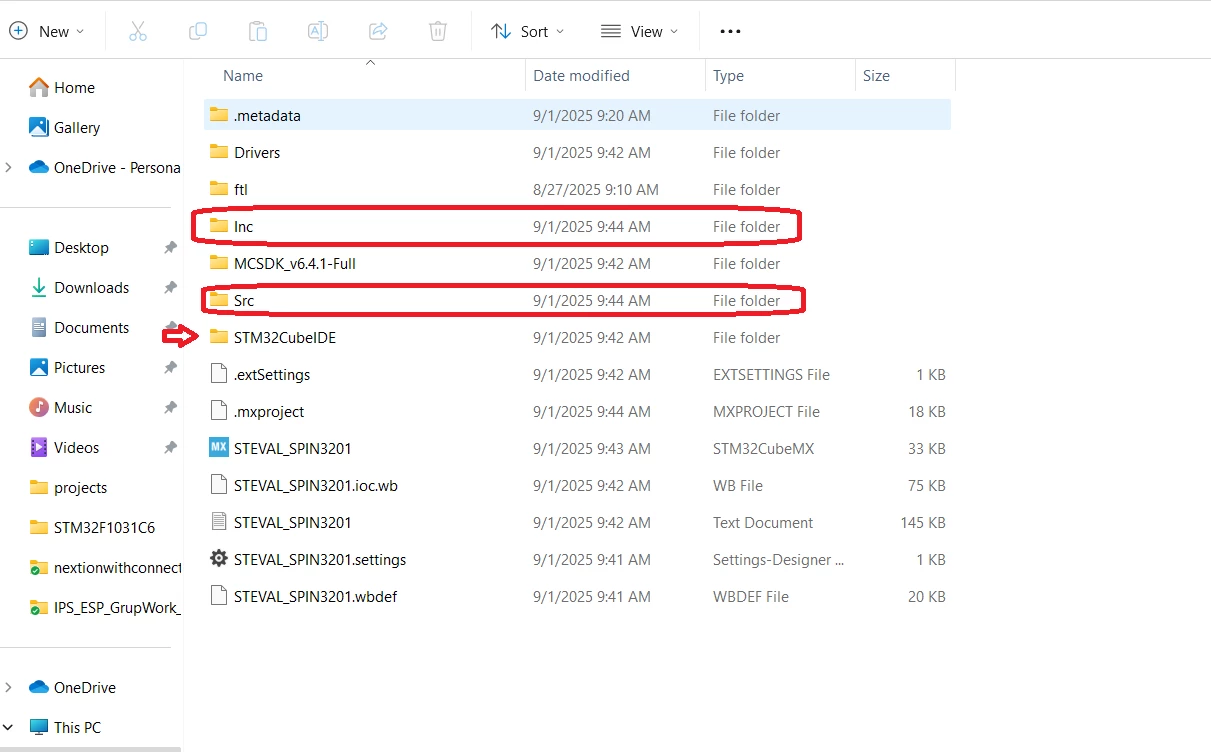

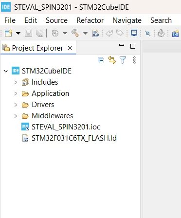

Hi everyone,
My evaluaiton bord is STVAL-SPIN3201 and I am using Motor Control Workbench 6.4.1.
First of all I work with Motor Control Workbench , after work CubeMx program and generate code and finally open CubeIde but I did not see Core folder. I dont know how can write my motor control program in main().c .
When open "C:\Users\eem_o\.st_workbench\projects\STEVAL_SPIN3201 " folder "Inc" and "Src" folder in this area.
When try to transfer at STM32CubeIde folder "Inc" and "Src" folders, given to many error.
How can solve this issue?

Don't transfer the files src and inc into Cubeide, write your program in either main.c in src folder or create a new .c file in src folder.
