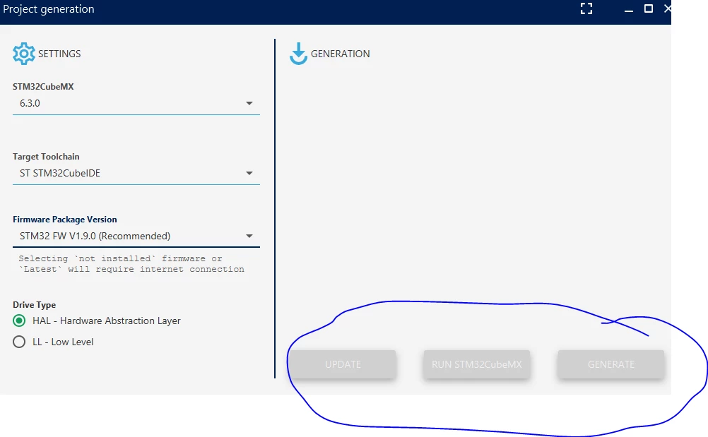

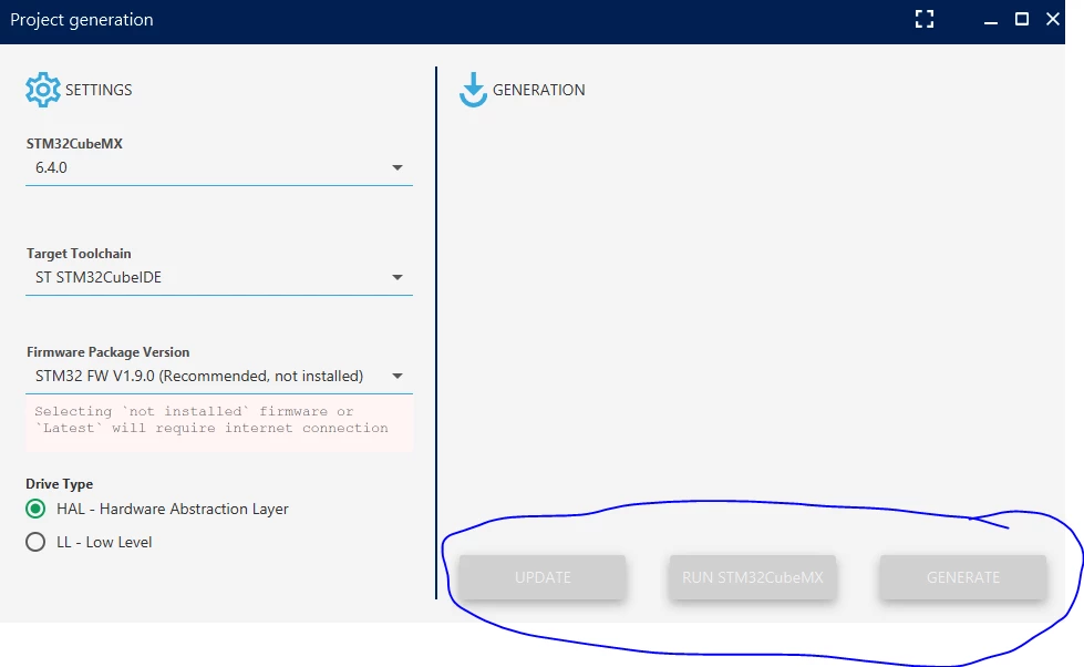

Hi Everyone.
For some reasons, we want to switch the current MCU to STM32H745 in our new generation designs. To make POC, We are trying to generate code for Nucleo H745 example in the C:\Program Files (x86)\STMicroelectronics\MC_SDK_5.Y.3\Projects\NUCLEO-H745ZI folder. So far, unfortunately, We could not achieve code generation.
We have tried different versions of the CUBEMX and also different version of the MCSDK software. In total, We´ve tried about 10 combination of that versions. but unfortunately We could not. On the other hand, for STM32G4xx and STM32F4xx series boards, we could achieve. In addition, I tried all steps with my personal computer (w10), but no success.
Here is a photo what i mean
0693W00000Hrfu9QAB.png0693W00000HrfusQAB.pngAlso, I tried all the H7 HAL SDK includin V1.9.1 , V1.9.0, 1.5.0 but no success.
So, It will be really appreciated if you help me on this.

Thank you for your answer,
The first photo indicates mxV6.4
Second photo indicates mxV6.3.
I also tried all possible combinations of CubeMX version, MCSDK workbench and H7 FW.
As I said, I achieved to generate code for F4 series and G4 series. But I need to generate for H7 nucleo board.
Best Regards
Samet Kocatepe
