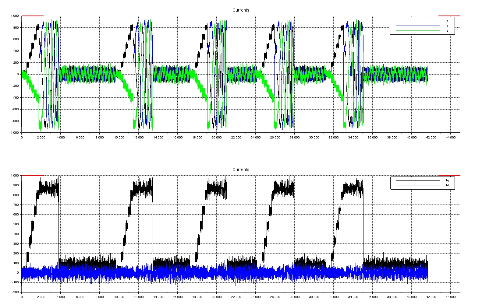

Here is a screen shot of the current measured with version X :
The plots represent 5 sequences of start stop. Each sequence is composed of two parts, one open loop start that consumes more current and a small current as soon as the observer takes the control.

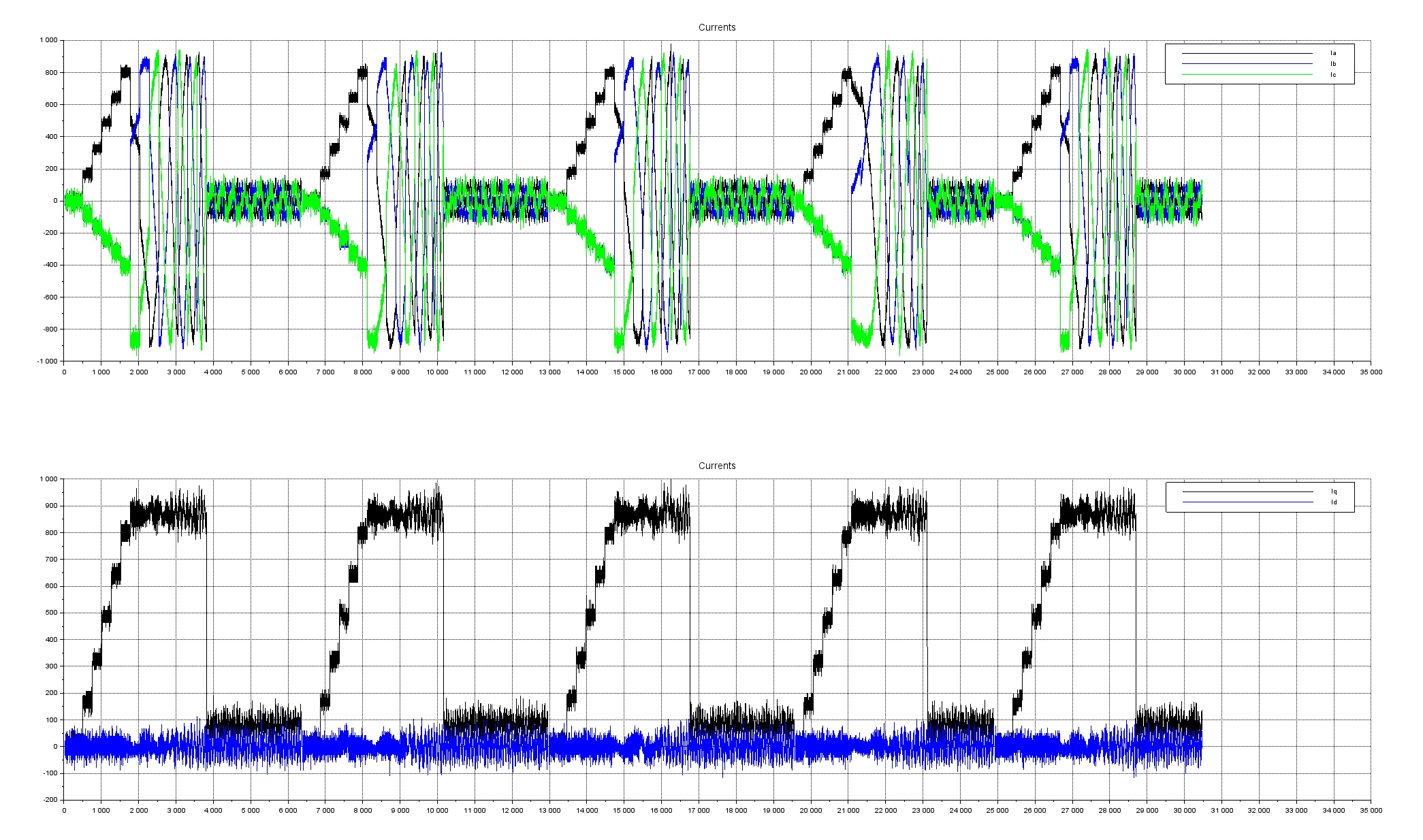

0693W00000HokPBQAZ.pngHere is the same measurement done with version Y:
Both versions produce very similar results.
0693W00000HokSnQAJ.pngCould you tell us a bit more about your software environment. Do you use the motorcontrol SDK, if yes which version ?
