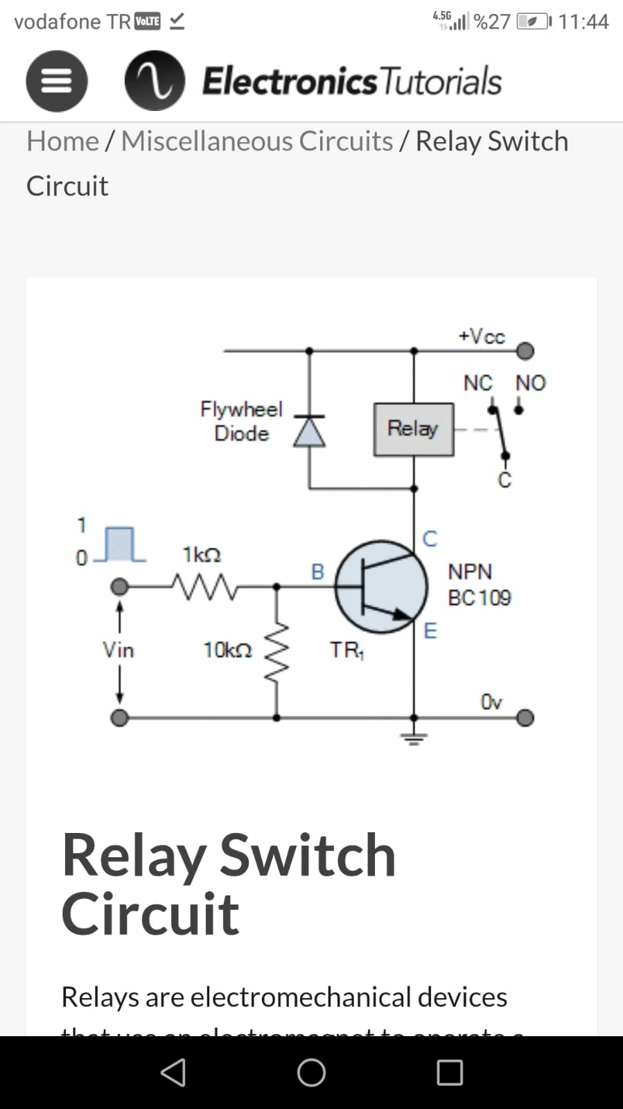

Why is MCU freezing?
I am using STM32G030K8 and driving 3 DC motors with relays in the circuit. Also I am controlling voltage of motors with MOSFET. Most of the time its working well but sometimes when I change the direction of motor with relays MCU stops working. I am using buttons for controlling motors. If relay pins were set when it happens, pins stay set and motors still working, it is becoming dangerous. Timer or GPIO interrupts stop working. 10% of times it goes hardfault_handler, %90 of times it stops working without going hardfault_handler. What causes this? and how can I solve this problem?

waclawek.jan
Aug 28, 2020 10:17 PM UTC
How do you switch the relay? Do you have freewheeling diode, snubbers? Post relevant portion of schematics.
kb24
kb24Author
Senior
Aug 29, 2020 8:57 AM UTC
0693W000002lhlCQAQ.jpgOur switch circuit is totally same with the circuit in the picture. Its my bad to ask question on Friday evening, I cant access the circiut or documents until Monday.
Dvorak.Peter
Aug 29, 2020 3:19 AM UTC
RE : when I change the direction of motor with relays MCU stops working.
I suspect relay contact arcing coupling to the controller
PCB layout is critical

waclawek.jan
Aug 29, 2020 10:25 AM UTC
Disconnect the motor. Make the relay switch fast, like 3Hz. Still problems?
If no,it's on the swiching (motor) side. As Peter said, switching inductive loads results in high voltage spikes even arcing. This is a group of problems which don't have a single simple solution, so you have to read and decide yourself; using a suitable snubber network may be a starting point.
