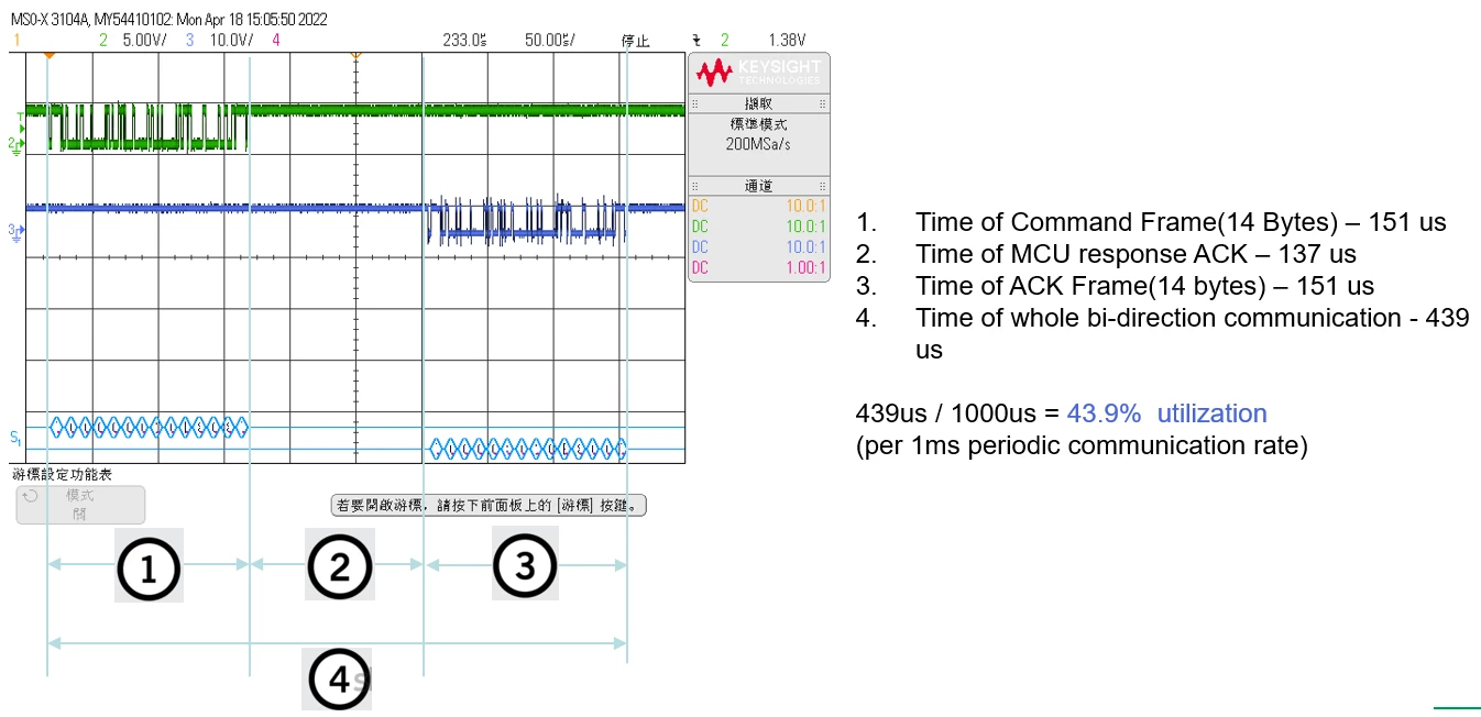

Hello Andrew,
Thank you for your comments.

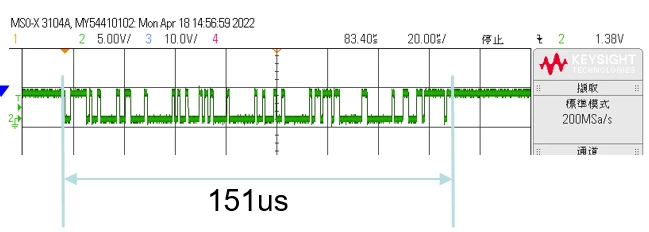

1.  The following is my communication protocol. Its packet length is 14 Bytes.
(The original data content is 4 bytes, but the entire packet includes SOF, EOF, some CRC, and a device identifier.)
Thus, each packet(14Bytes) should takes about 121µs (The actual experiment result is 151µs.) base on 921600 baudrate configuration.

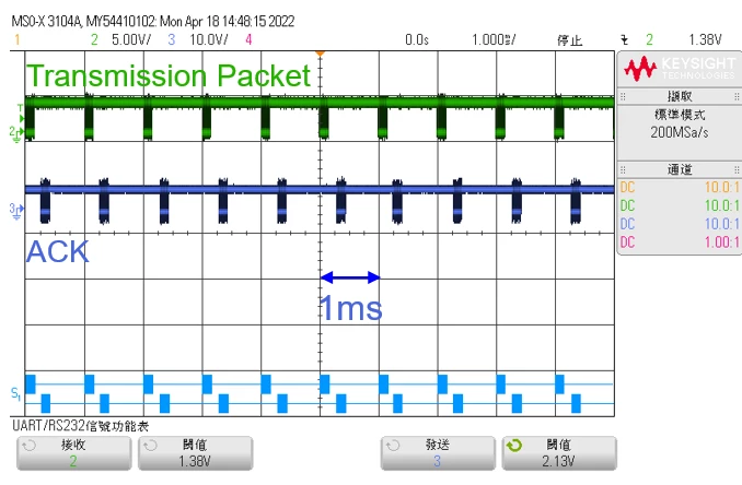

The following waveform was measured at a communication rate of 1 kHz and it is in handshake mode. (Each transmission is followed by a corresponding acknowledge)
Room in on only one handshake transmission.
You can notice that even at a communication rate of 1 kHz, the transmission utilization has already reached approximately 43.9%, based on a baud rate of 921,600.
It is completely unable to achieve a 20 kHz update rate. Moreover, I might need to upload multiple pieces of data simultaneously, such as speed, current, temperature, etc.,
Yes, the STM32H5 supports USB, Ethernet, and SPI. Therefore, I would like to consult experienced person on which interface is more suitable for high-speed/real-time communication needs before I start development and integration.
