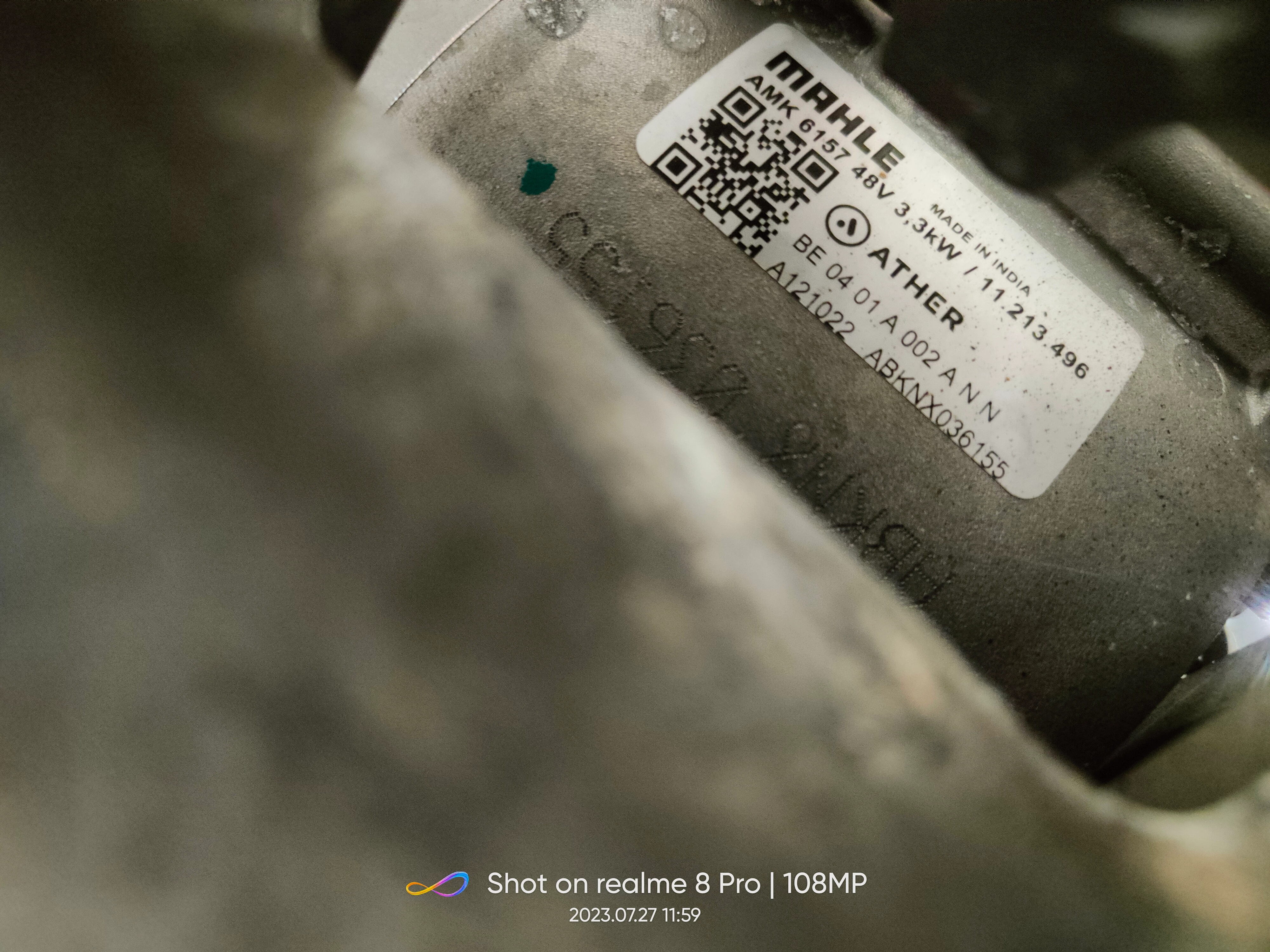

which board is suitable for this motor "mahle 48 volt 3.3KW motor"
we have a ather  electrinc schooter ,they have used the 48 volt motor .motor image is attached .i am confusing that for this motor which board we can use for no load run ?IMG20230727115945.jpgIMG20230727115940.jpg

Hello @Ranjeet Singh
I suggest the St Mc Suite tool, which lists you the Motor Control compatible boards with the details, Here is the link :
https://www.st.com/st-mc-suite/home/
- Click on - Start -> Engine Control Solution
- select the motor type (BLDC)
- select the algorithm
- then choose your board in Power Board
The STEVAL-CTM009V1 board can meet your expectations.

at 48 volt using  STEVAL-CTM009V1  board what maximum current we can draw from this  board ?
i think 104 A . am i right ?
September 22, 2023
For the voltage you are looking for, you have
EvalStDrive101
Rated Voltage: [6 - 75] V
Rated Current: 20 A
And STEVAL-CTM009V1
Rated Voltage: [5 - 48] V
Rated Current: 200 A
Both will be supported by MCSDK 6.2 which will be released very soon
"If you agree with my answer, please accept it by clicking on ""Accept as solution""."
