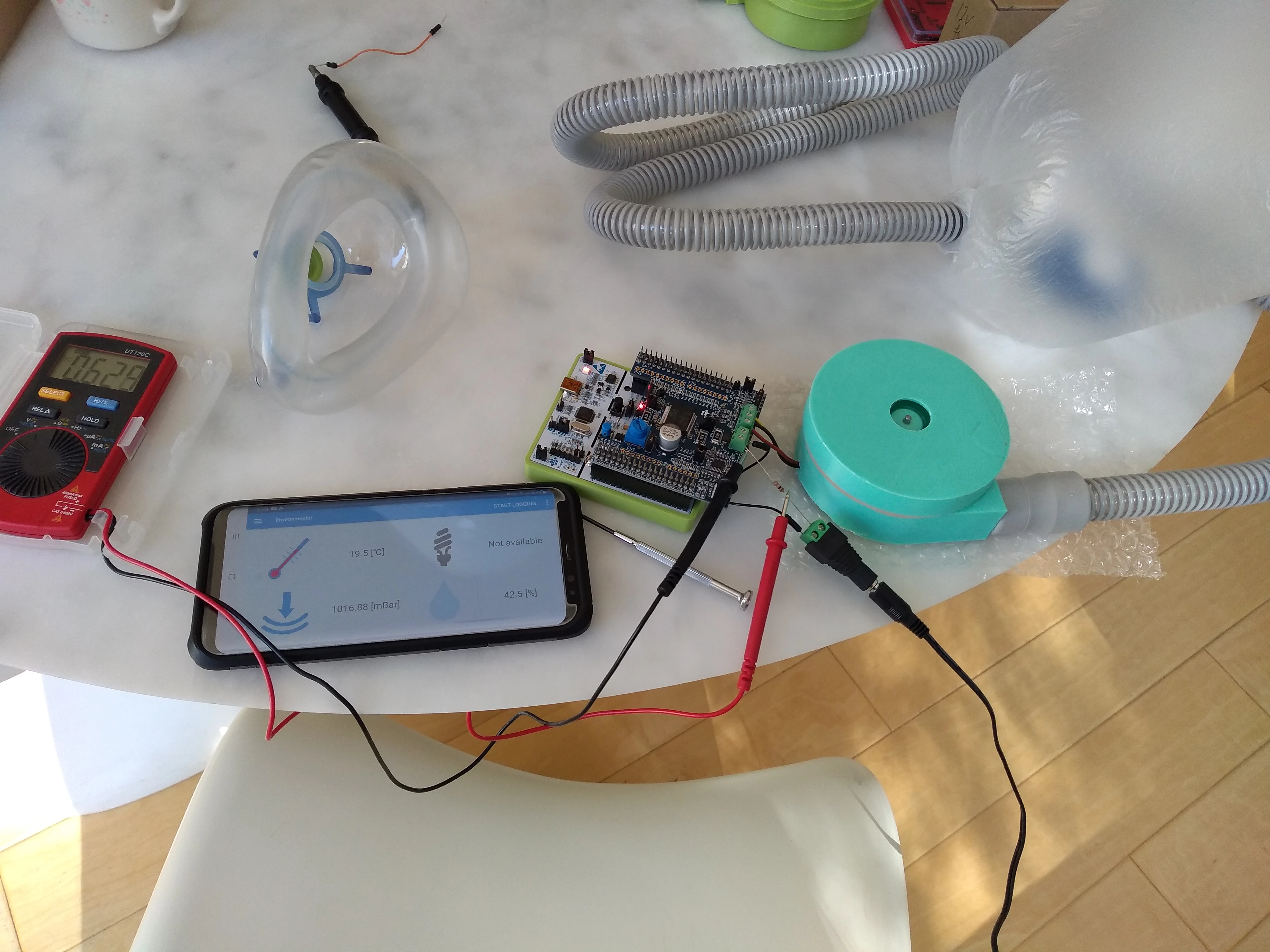

Where is the binary firmware for p-nucleo-ihm001 MCU board that the user manual UM1949 says is available on st.com?
The document UM1949 says:
The original firmware demonstration to reprogram the STM32 MCU of the
P-NUCLEO-IHM001, is available in binary file format from the www.st.com
website and it is called P-NUCLEO-IHM001.bin.
Also where is the source code for that firmware?

I am planning to use the board and the motor in a COVID response ventilator, so this is a bit urgent!
