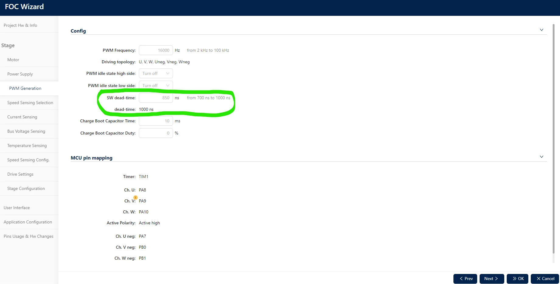

What is the difference between "Dead Time" and "SW Dead Time"? (MC SDK)
Dear All,
I just stat to evaluate the MC SDK.
My platform: MC SDK v6.3.0, NUCLEO-H563ZI, X-NUCLEO-IHM08M1.
Have anyone know what's the difference between "Dead Time" and "SW Dead Time" as follow figure?
Per it's default configuration, (SW dead-time is 850ns,  dead time is 1000ns), what is the exact value of dead-time to the power stage?

    Refer to the PWM generation chapter in the MCSDK6.4x user manual, which is available through "Workbench tool > About > Documentations > Documentation".
    If you agree with the answer, please accept it by clicking on 'Best answer'.Best regards.GMA
    Visitor II
    Jan 15, 2026 11:09 AM UTC
    Thanks!
    For anyone wondering, it is in this path:
    *MCSDK_INSTALLATION_PATH*\Documentation\html\md_docs_2_p_w_m___generation.html
    In my case, this was: C:\Program Files (x86)\STMicroelectronics\MC_SDK_6.4.1\Documentation\html\md_docs_2_p_w_m___generation.html
    Anyways, the short version is that "dead-time" is a fixed hardware value used only for calculations when driving high sides and enables. This is defined in the board .json file as "deadTime". The "SW dead-time" is a configurable value actively written to the timer register when driving both high and low sides. The range available is defined by "minDeadTime" and "deadTime" in the board .json file.
