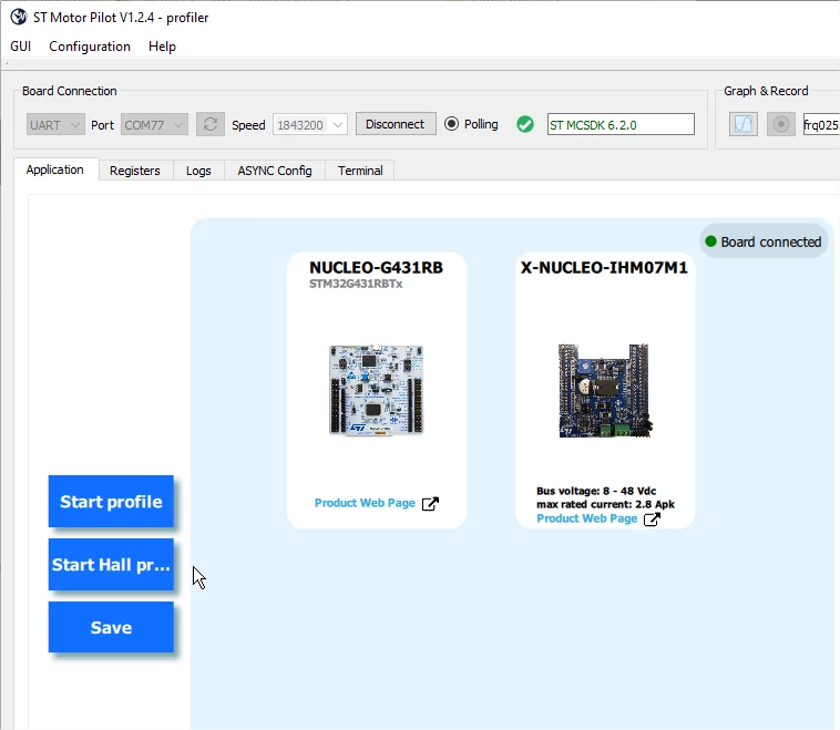

what is placement electrical angle when we use hall sensor as a main sensor in motor control workbench?
hello.
currently, I am working on the P-NUCLEO IHM03 3SH kit with my motor
motor specification is mentioned below
pole pair = 6
V = 56.4
RPM = 2100
I want to use the hall sensor as speed sense but I can't understand how to find the placement electrical angle for this my sensor displacement is 120 degree

DMeie.2
February 1, 2024
The user manual says to "Enter two parameters displacement and delay found in the ST MC Workbench GUI".
There's no option "delay" in the motor configuration GUI, just "Sensors displacement" and "Placement electrical angle".
The guide also shows a delay in time in its graph and also goes into the negative, but there's not formula how to calculate that into the required angle.
So how do I actually get the "Placement electrical angle"? The user manual isn't really helpful here.

Sorry for this misunderstanding.
You can do HALL sensor profiling with Motor pilot profiler.
Using WB6.2.0, please generate a project with main speed sensing STO_PLL, Auxiliary sensing set to HALL (for this, go on motor box and switch on HALL sensor if not already set) and set "Motor Profiler" in Application Configuration tab.
Launching Motor profiler, once motor profiler done, you will have HALL sensor profiler:
