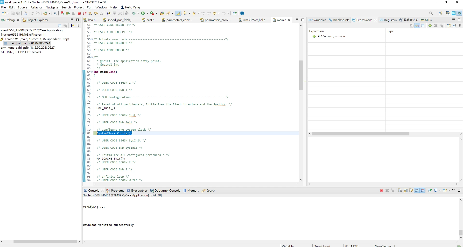

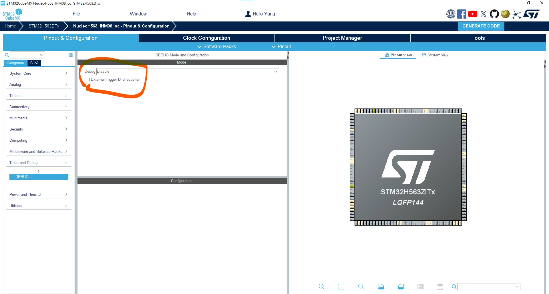

I notice a very curious pheonmeon. In CubeMX, I didn't configure any SWO or JTAG pins, they are all disabled. However, when I generate the project, I am still able to download the program into MCU by ST LINK on the board ( USB Type-C) and go into debug mode.
Why is that?
Disable all SWO/JTAG function
Download and go into deubg mode  Successfully

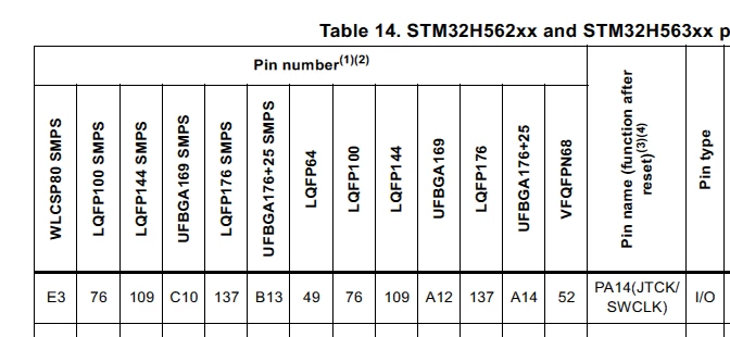

    its not a curious pheonmeon .
    YOU didnt configure SWD - but the chip has a default on power up , setting some pins to a default mode.
    So SWD enabled at start...
    see ds, pin default settings !
    like this:  (note...function after reset ! )
