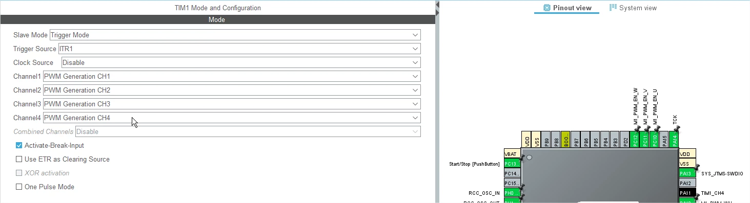

Is there a way to toggle an I/O pin when the ADC sample is actually taken? Then I could look with the scope to see when the current is actually sensed compared to the corresponding phase Vgs waveform
GMA
Mar 3, 2022 12:51 PM UTC
Using CubeMx, you can output the TIM1_CH4 that is linked to the sampling position:
If you agree with the answer, please accept it by clicking on 'Best answer'.Best regards.GMA
