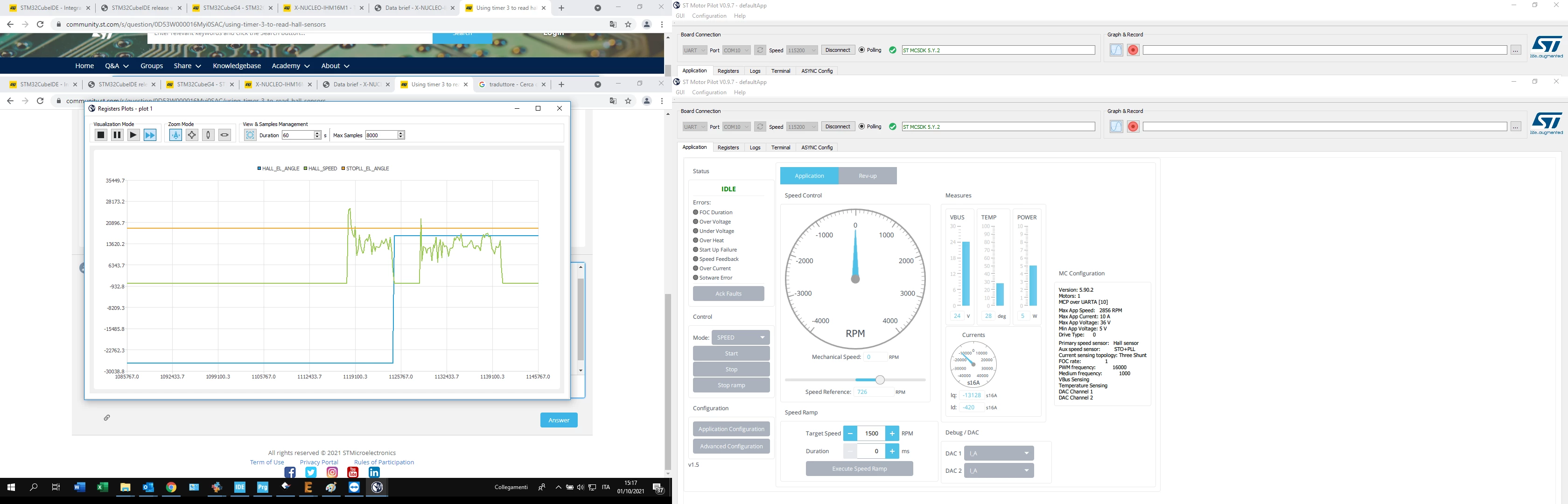

The first thing I would try is to generate a project with sensorless (STO-PLL) as primary sensor, and Hall sensor as auxiliary sensor.
With this project build with SDK 5.Y.2, you will be able to plot the angle generated by the STO-PLL algo, and the Hall sensor algo.
The signals name are STO_PLL_EL_ANGLE and HALL_EL_ANGLE.
Attach to this thread a screen shot of this plot containing the two angles, and based on it I will have more clues to help you.
Regards
Cedric

thank you for your answere, in attached your request:
0693W00000FBBWuQAP.pngThanks
BR

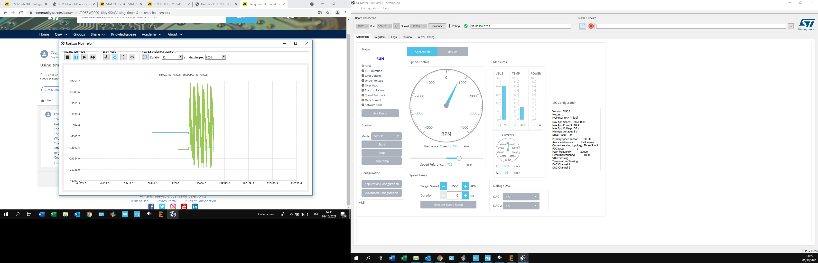

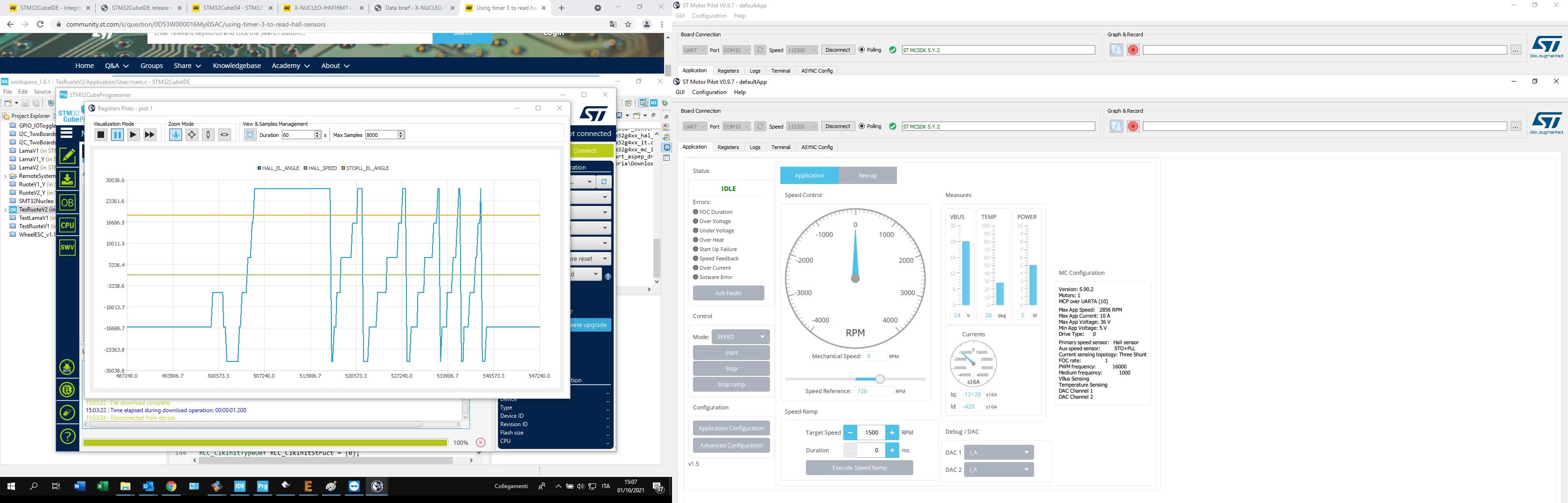

In attached another print screen where seems that are read by MCU and sent to the PC firmware but not use by FOC algorithm, consider that i'm rotating the motor by hand (very slow):0693W00000FBBubQAH.pnganother where i'm rotating the motor around 1000rpm:
0693W00000FBBwmQAH.pngthanks BR

Is your motor spinning fine with the STO-PLL as primary sensor ? the shape of your angle is not what I expected.
Please have a look at the following thread :
https://community.st.com/s/question/0D53W000016n4ZZSAY/can-we-use-hall-sensor-as-main-sensor-and-no-auxiliary-sensor-to-run-the-motor-can-we-control-the-speed-of-the-motor-how-to-decide-the-placement-electrical-angle-default-300-in-workbench
The image I post is done with an oscilloscope based on 5.4.7. but I do expect the same curve with the 5.Y.2 with the new mPilot.
So the first thing is to have a clean STO_PLL_ANGLE shape.
Now regarding the Hall sensors, the first thing I would advise you to do is to set a break point in the SPD_TIM_M1_IRQHandler function inside the stm32g4xx_mc_it.c in order to check that when you manually rotate your rotor, your timer interrupt is properly triggered. You have to be sure that each transition of the three hall sensors signals are able to trigger the timer interrupt.
