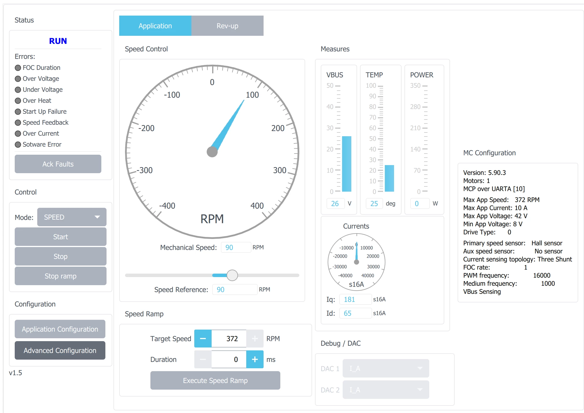

With the release SDK5.Y release, comes the new motor Pilot tool that allows you to log the data coming from the FOC algo without any loss.
If you want to check the current, you can plot the current waveform.
In the motor Pilot you will find a "Graph and Record" frame, if you click on the "Graph" button a high frequency plot window will pop up, and from there you can select to plot Ia and Ib, (you can also record them if you want to do post processing).

It turns out that the "Motor pilot" application returns a completely correct zero current value in s16A units, but the MC_GetPhaseCurrentAmplitudeMotor1(); behaves strangely. I would agree that this is a polarization of 2.057V, but the function should return not a 12-bit ADC value, but a 16-bit value, that is, there is some processing up to the s16A format.
