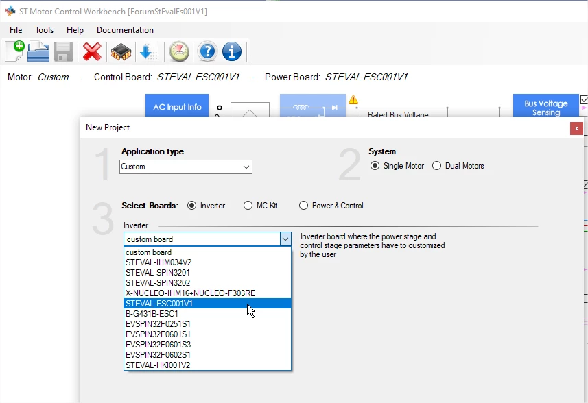

User manual UM2200 for STEVAL-ESC001V1 (purchased recently) tells me to install STSW-STM32100. I have searched st.com but cannot find it. The databrief tells me I shall have a motor running in minutes. So far it's 3 days. What do I do?

Could you try using Workbench MCSDK5.4.8 e.g.? You can generate your project as below:
0693W00000QLRuCQAX.pngBest regards.

Thank you for your answer. I ended up using Motor Control Workbench 5.Y.4 following an answer by KnarfB, to a related question. I think a key part of the puzzle for a newcomer is to realise that you have to select from inverter rather than Power & Control.
