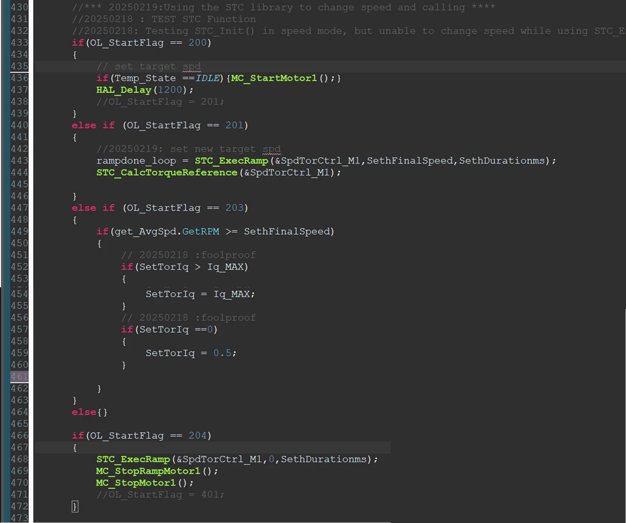

I am currently testing the use of STC_ExecRamp(). In WORKBENCH, the default speed is set to 1000.
However, when I call STC_ExecRamp() in the code and change the speed to 500, the readback speed is still 1000.
I have set it to Speed Mode.
Could anyone point out what might be wrong?

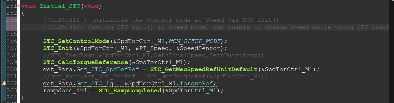

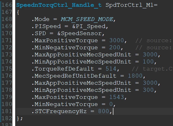

However, the issue is that when I use MC_ProgramSpeedRampMotor1(SethFinalSpeed/6, 1000) in the while loop to control the target speed, it works correctly.My main goal is to implement Speed+Torque control. I saw content related to Speed & Torque Control in the documentation, so I was wondering if I need to use STC-related commands to achieve this.
Please kindly show me where I made a mistake.
Attached are my STC initialization and control logic inside the while loop.

Sorry, maybe I missed one point; to control torque or speed ramps, you have to use available APIs
MC_ProgramTorqueRampMotor1_F()
MC_ProgramSpeedRampMotor1_F()
