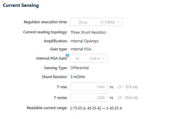

I've made a custom card and I'm stuck on two features in particular:
- over-current protection
- Current sensing
They don't show up in the ST Workbench Pannel.
[VERSION]: 6.1.2
[TOOL]: MC WB
[DETAILS]:
here is an extract of my custom board  (current Sensing):
 "name": "CurrentSensing",
 "type": "CurrentSensing",
 "tRise": 59,
 "hwVariants": [
 "type": "SingleShunt_AmplifiedCurrents_noOffset",
 "shuntResistor":0.0005,
 "opAmpGain":20,
 "amplifyingNetworkImax":330,
 "amplifyingNetworkVm":3.3,
 "amplifyingNetworkPrating":10,
 "signals": {
 "CURRENT_AMPL": [
 "name": "PA3",
 "help": "",
 "cost": 0
And for overcurrent protection :
 "name":"OverCurrentProtection",
 "type":"OverCurrentProtection",
 "hwVariants": [
 "type":"SingleInput_RawCurrents_Protection_IntRef",
 "OCNetworkGain":20,
 "OCNetworkOffset":0,
 "OCComparatorThreshold":2,
 "OCSignalPolarity": "Active high",
 "signals": {
 "CURRENT_INPUT_P":[
 "name":"PA7",
 "help":"",
 "cost":0
Yet, on WB view, I got these  :
I'm working on a custom Inverter with a STM32G431RTBx and all the other features show up well.
[EXPECTED BEHAVIOR]:be able to activate overcurrent protection and current sensing.
Thank for your help,
Irian

Hello @IrianJ,
Do you want to use FOC algorithm or 6-steps ?
What is you targeted MCU? 6-steps algo is supported on a limited series compared to FOC.
Do you use a ST board you want to modify as a starting point ? if yes which one ?
SingleShunt_AmplifiedCurrents_noOffset is dedicated to 6-steps because the current sampled is always positive.
Regarding the OverCurrent protection, may I ask you what is your driver? Most of the time drivers have a Fault signal that is use in the MCSDK for the Driver Protection feature. Your Hardware Variant makes use of raw currents, it means non-amplified current ( connected directly from the shunt). I guess it is not your use case.
Regards
Cedric

Hello @cedric H,
Thank you for your time and your reply.
Here's a bit more background on my use of the tool. I want to evaluate the software generated by ST Workbench on our own motor controllers and motors  (which run today on our own  software).
- I want to use 6-steps only. MCU used is a STM32G431RBT6 (which is compatible with FOC and 6-steps). I am not starting from a ST board  but I'm using them as examples to build my controller's board description.
The driver used is DRV8350RSRGZR but  we want the software to be as driver-independent as possible, as the driver may change in the near future and it already has two single-shunt (redundant) current measurements in place.
You are right ! We do not use raw current ! We have two amplified current input. I want to use one for current sensing, and the other for overcurrent potection with a internal comparator and internal generated reference (as we do in our proprietary software). The two currents  inputs have the same amplification ratio. Maybe this is impossible with the workbench ?
Regards,
