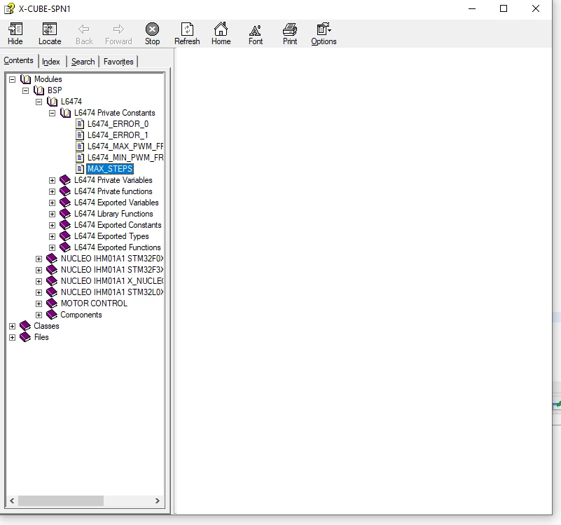

UM1848 Documentation needs to be updated. It is from February 2016 (DoclD027273 Rev 2) and STM32CubeIDE has changed a lot since then.
I just bought a NUCLEO-F104RE and the X-NUCLEO-IHM01A1.
The main problem is have is where to put the en.x-cube-spn1 files.
The instructions in Section 3.3 need to be a little clearer and more specific.
Also there is no .ioc file in the software.
Do you build a default (in my case) Nucleo-F401RE board project then start over writing files from the files in en.x-cube-spn1? It does not say.
The compiled help files like X-CUBE-SPN1-HELP.chm does not work right.
I can see the contents, but no text under the contents. Please just give a .pdf of the detailed information and screw the help file.
Paragraph 3.3.1.1
Where do the files from the BSP folder go? Do you create a BSP folder in the project? Where? Under Drivers? Or under Core? Or does the .h files go into the /Core/Inc and the .h files go under /Core/Src? Or somewhere else?

I copied the file clock_f4.c from the D:\en.x-cube-spn1\STM32CubeExpansion_SPN1_V1.11.0\Projects\Multi\Examples\MotionControl\IHM01A1_ExampleFor1Motor\Src directory to the project Core/Src/ directory. Now it says it cannot create it.
There is no
11:24:21 **** Incremental Build of configuration Debug for project IHM01A1_demo ****
make -j12 all
arm-none-eabi-gcc -mcpu=cortex-m4 -g3 -c -I"../../../Inc" -I"../../../../../../../../Drivers/BSP/STM32F4xx-Nucleo" -I"../../../../../../../../Drivers/BSP/X-NUCLEO-IHMxx" -I"../../../../../../../../Drivers/BSP/Components/Common" -I"../../../../../../../../Drivers/BSP/Components/l6474" -I"../../../../../../../../Drivers/CMSIS/Include" -I"../../../../../../../../Drivers/CMSIS/Device/ST/STM32F4xx/Include" -I"../../../../../../../../Drivers/STM32F4xx_HAL_Driver/Inc" -x assembler-with-cpp -MMD -MP -MF"startup/startup_stm32f401xe.d" -MT"startup/startup_stm32f401xe.o" --specs=nano.specs -mfpu=fpv4-sp-d16 -mfloat-abi=hard -mthumb -o "startup/startup_stm32f401xe.o" "../startup/startup_stm32f401xe.s"
make: *** No rule to make target 'C:/Users/Moravec-Kipton.DOMNDTX/STM32CubeIDE/Src/clock_f4.c', needed by 'Example/User/clock_f4.o'. Stop.
make: *** Waiting for unfinished jobs....
"make -j12 all" terminated with exit code 2. Build might be incomplete.
There is no Example/user/ directory for clock_f4.o. I am guessing the .project or .cproject is not right or I put things in the wrong place because the documentation is not right or incomplete or just 6 years old.
You guys can do better than this.
