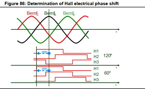

UM1052 Back emf waveform
In the determination of the Hall electrical phase shift shown in the UM1052 document
_legacyfs_online_stmicro_images_0693W00000bl31EQAQ.pngPlease tell me BemfC i am assuming it is C with respect to A ?
BemfA is Phase A with respect to B?
BemfB is Phase B with respect to C?
I mean it is the phase to phase voltage and not phase to neutral voltage?
