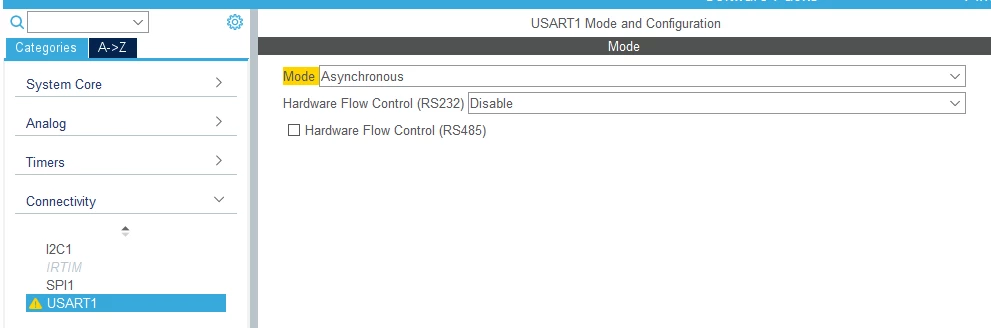

Hi ST,
I am unable to establish UART communication between ST MotorPilot and STEVAL-SPIN3202.
I am uploading one of the two STEVAL-SPIN3202 examples.
Setting up 9600 baud rate (same as in Cube MX settings). Using correct COM port.

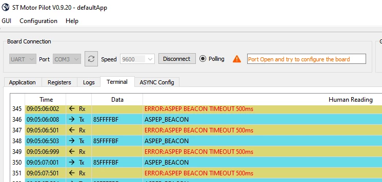

I am trying to connect with ST MotorPilot - result:

May I ask a question, did you check on workbench interface if UART IP is available (digital i/o box)?
In the example below, it is not available...
0693W00000KaZe3QAF.pngIf it is the case, I assume that you are using a WB5.Y. if yes, could you try with WB5.4.8 please?

Hi GMA,
Thank you for the answer.
I ran WB4.5.8
0693W00000Kaa09QAB.pngNow UART is active.
I am not sure where I can find  UART IP  (digital i/o box) on Workbench interface.
In MX, Hardware control is disable by default.

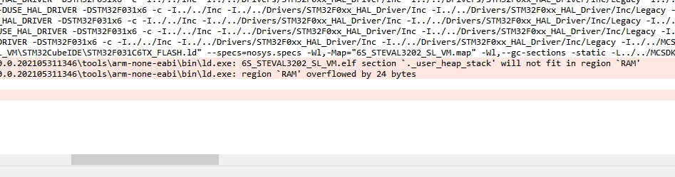

After attempt to copmpile and run:
It does not fit to RAM by 24 bytes.
How can I fix this?

Could you try using "LL - Low Level" for "Drive Type" on Project generation option?
If you agree with the answer, please accept it by clicking on 'Best answer'.Best regards.GMA

February 25, 2022
Hi GMA,
Thank you very much!
I changed the Drive Type as you suggested.
Now UART communication with Monitor works.

Had this same problem today. To recap for others when using STEVAL-SPIN3202:
  • MCSDK-Y's Motor Pilot does not work with the SPIN3202 even though is shown as an option. You need to use MCSDK 5.4.8 and its Motor Monitor utility.
  • Drive type needs to be "Low Level" when generating/updating in MC WB. HAL is too large even when using code optimization.
