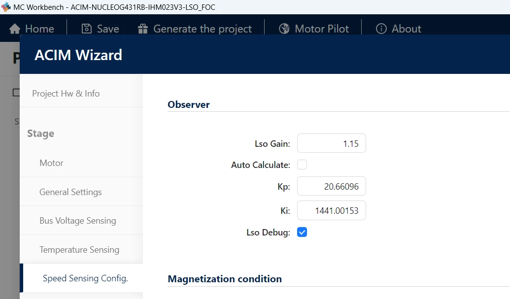

Setting Up LSO Gains
While creating the project in MC Workbench (MC WB), I came across some variables whose values I'm unsure about, such as the KP and Ki gains for the LSO observer. The ST documentation mentions a general gain range of 1-1.5 for the observer, but it doesn't provide information about the controller bandwidth or how to manually edit KP and Ki.

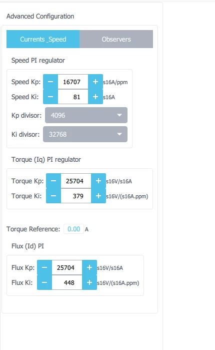

Current and Speed Controller Gains

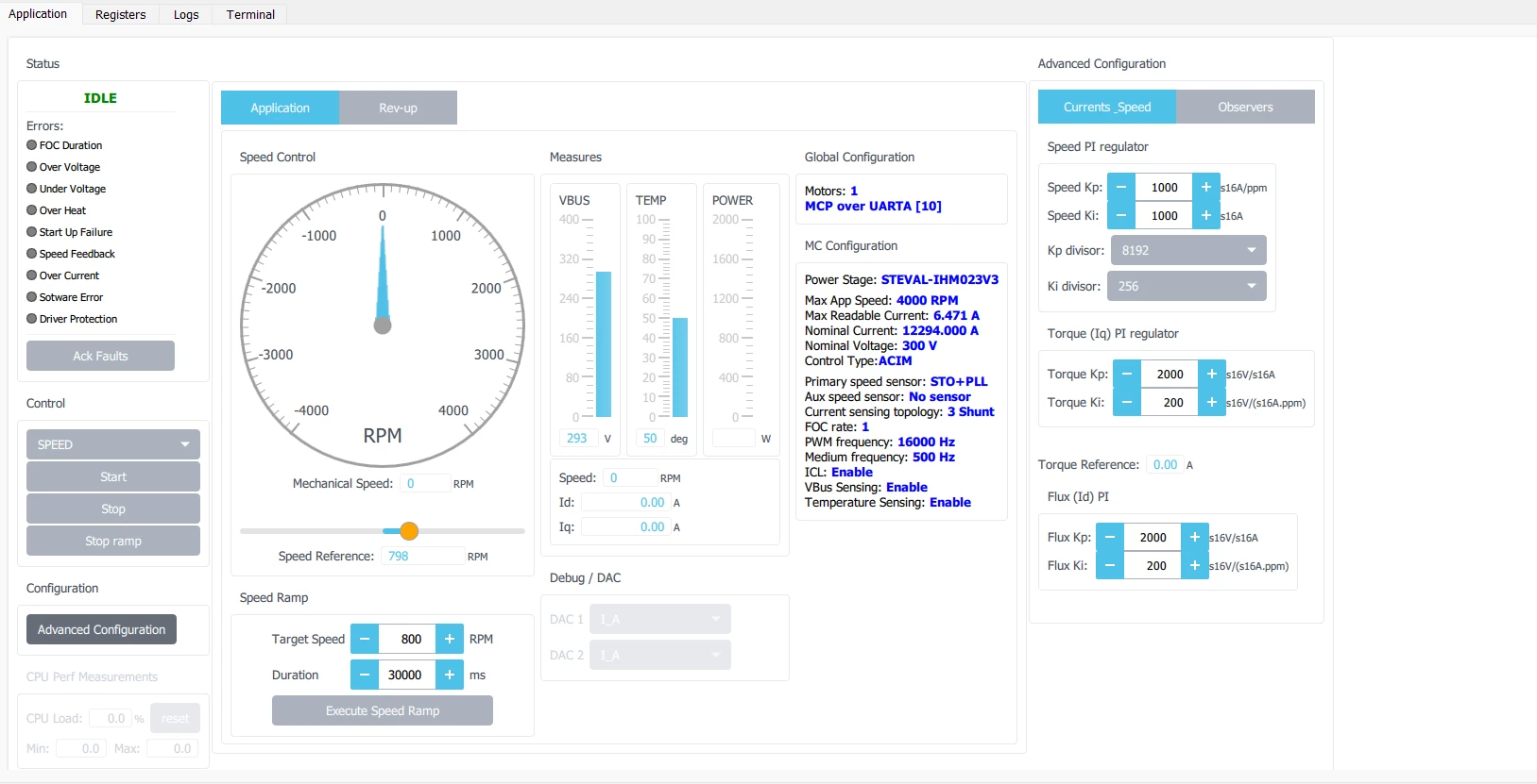

Based on my understanding of FOC loop theory, I estimated the KP and Ki values for the speed and current controllers. However, during testing with Motor Pilot, it seems the values have specific units, and I'm unsure how to adapt my values to them (see attached image).
Experimental Issues
Using some estimated values, I was able to build the project. However, in most cases, I've encountered stability issues when the current and speed Ki values are non-zero. Additionally, the observed speed doesn't match the actual speed. Furthermore, if the motor attempts to reach its nominal speed (around 1700 rpm), instability occurs upon reaching that speed, with errors like "speed feedback error" or "overcurrent error" appearing in Motor Pilot.

The Kp/Ki of the observer are used to compute the observed electrical angle : the integral part of a PI is used as an integrator. The PI is fed with the observed speed so we can retrieve the observed rotor angle -> d(theta)/dt = speed. These Kp/Ki (of the observer) have to be set in order to get acceptable BW and to be in line with the max electrical speed/current/.. of your system.

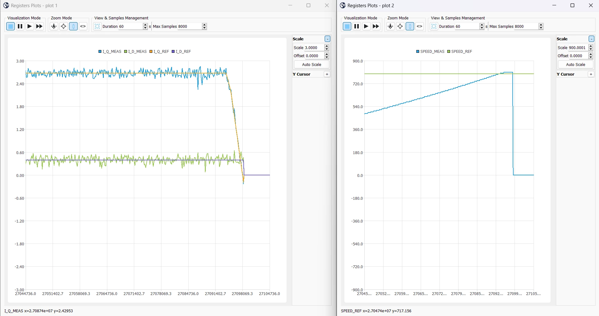

I’m working with a motor running at 1750 rpm, 0.37 kW, and 1.94 A @ 220V. I was able to get a current probe and a tachometer to tune the current controllers, but I’m having some problems tuning the speed controller and the observer parameters.
Using the tachometer, I compared the real speed with the observed speed and found a difference of around 50 RPM during acceleration but the main issue is that when the observed speed reach the target speed, iq is reduced (as part of the control loop) to regulate the speed,  however even when the real speed of the rotor is reduced (measured with the tachometer) the observer does not register this change and think the speed is still high therefore keeps reducing iq ref until the motor stop but the observer is still obtaining a wrong speed and then the control loop gets out of control.(See images)
I think that i have a problem with the observer Kp/Ki and/or K gain, but i have tried different values but i was not able to fix it. I would greatly appreciate any suggestions  to help me troubleshoot this issue.

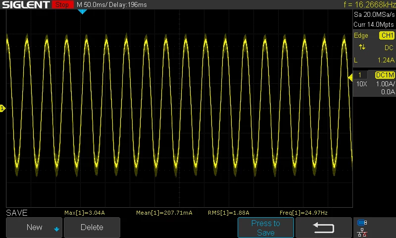

Additionally, I tuned the current controller, and the waveform I obtained is as follows:
Does this look good to you? Let me know if you need any more changes!
September 4, 2024
Hello @carlos_gtronix
From the screenshot it seems the current waveform is smooth without any jitter/noise; you may even try to increase the Kp/Ki of the current controllers (same values for Iq/Id for instance).  Anyway, that is not your main concern for the time being. Are you using a custom motor prototype, is the datasheet available somewhere on the net?
