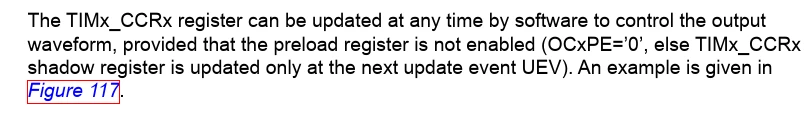

    AScha.3
    June 17, 2024
    I cannot imagine, why dis-/enable should have a big delay - except, there is no "update" event.
    (You writing values to the shadow registers, only on "update" they are loaded to the "real" . But OC enable or disable should work always.))
    Which chip we talking about here ? F405 , i see.
    Try call "generate update event" (dont know how its name exactly) after your enable ,
    or
    just write to dis-/enable the matching value to CC register, "0" to disable and "your value" to enable pulse.
    (I would do it this way , always.)
    waclawek.jan
    June 17, 2024
    TIMx_CCER.CCxE bits *can* be preloaded, see TIMx_CCMR.CCPC (and .CCUS). However, this preload does not work through Update, but through the rather obscure Commutation event.
    If this is the case, the Commutation event should be forced by setting TIMx_EGR.COMG, for the TIMx_CCER.CCxE bits to get active immediately.
    Observing TIMx_CR2 content would reveal the truth. However, the question then also is, why is there the preload set at the first place, and then if such forced Commutation would not spoil some grand scheme.

    June 17, 2024
    So
    waclawek.jan
    June 17, 2024
    Read out and check/post the timer registers' content.
