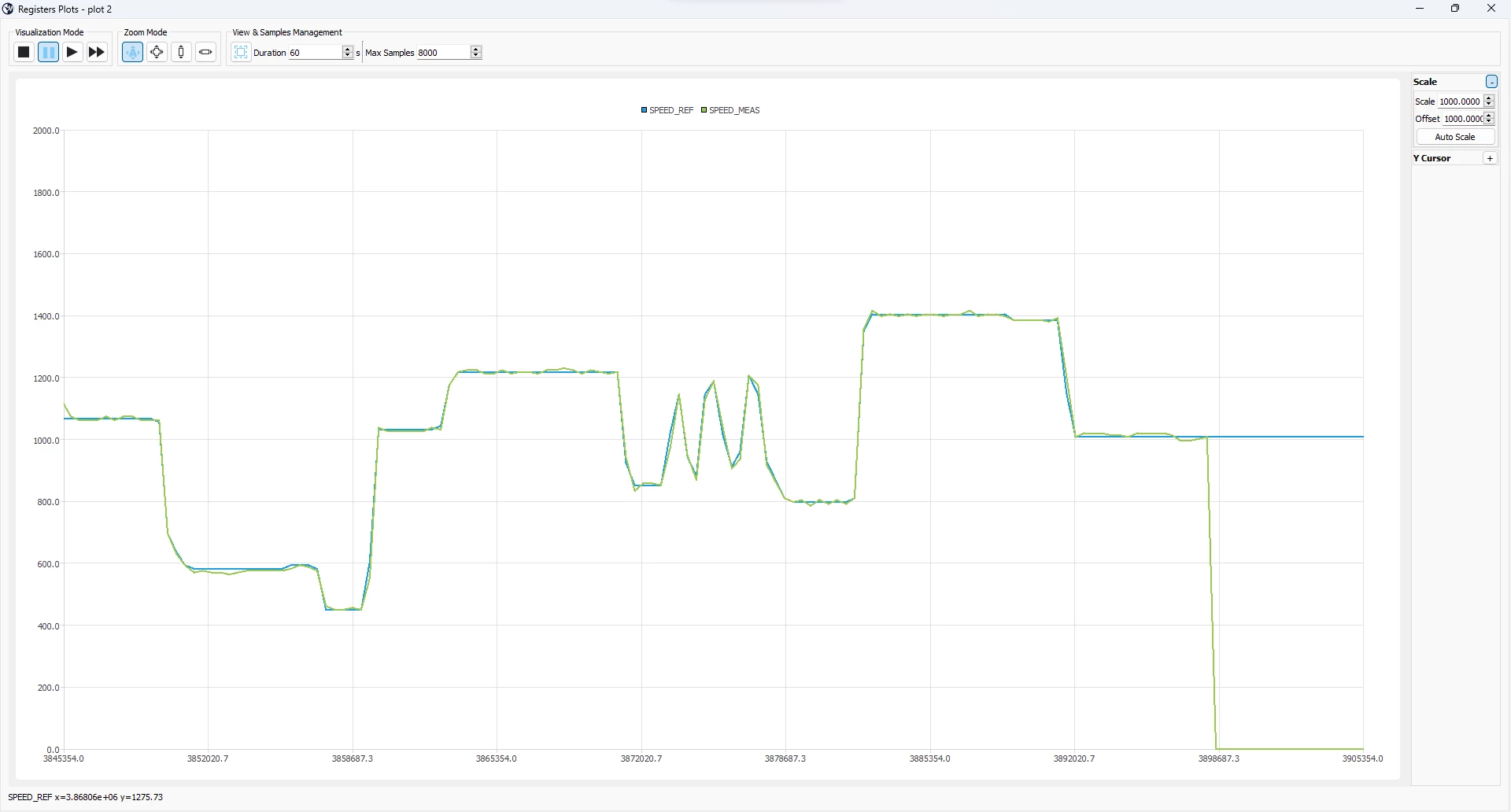

Torque waveform in P-NUCLEO-IHM03 Project
Just like, we can monitor current, speed waveforms in Motor Pilot of P-NUCLEO-IHM03, can we somehow see Torque waveform in it as well? Or by any other means to monitor torque performance?

Dear @tejas_amp ,
It is really important you spend time reading our documentation to understand the basics of motor control.
The torque is Iq and is available from the high frequency plot.
