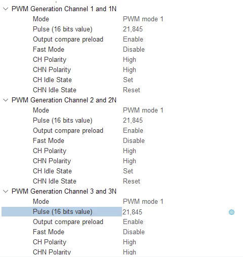

I have followed the NUCLEO-IMH03 motor workbench. Now i want to replicate PWM generation on the NUCLEO-IMH03. I use TIM8 CH1,2, and 3 as PWM CH and CHN. Timer TIM8 CH4 i set as PWM No output generation. I copy all the settings from motor workbench settings. After generate code i add in the main function

According to me you can TIM8 for Ch1, Ch2, Ch3 and for trigger source you can use ITR1 which is tim2_trgo but only thing is you have to start the timer2 then you will get the PWM in my understanding.

thank you very much for the response. I did as you have mentioned.
If you could maybe just write few words how did you come to this conclusion. For example what is first column TIMx? And how did you chose timer2? I imagine that is TIM2? Could you elaborate a bit?

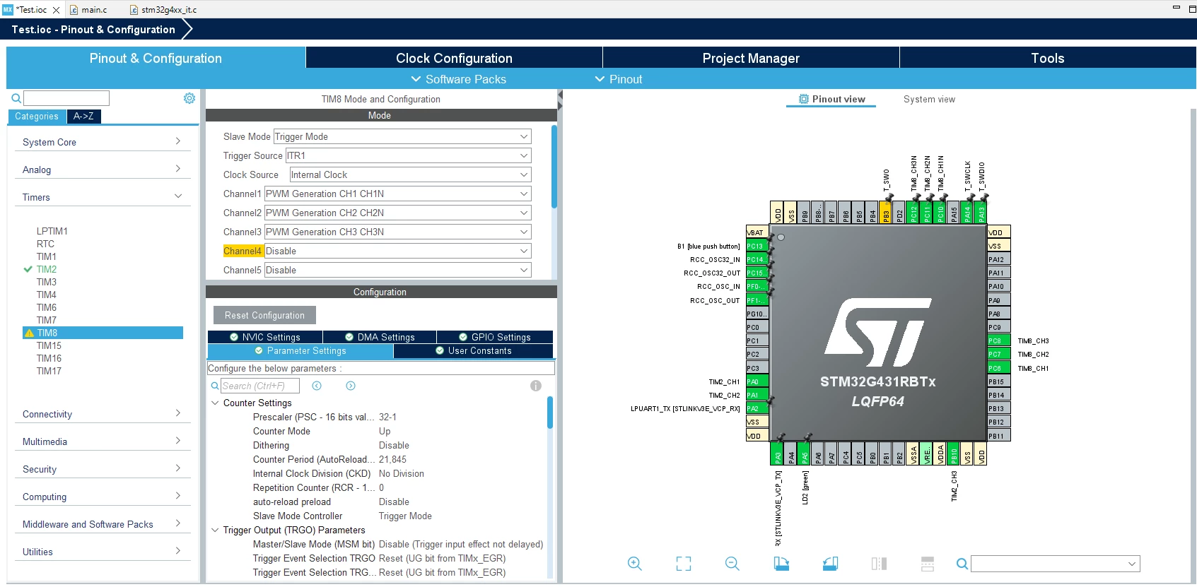

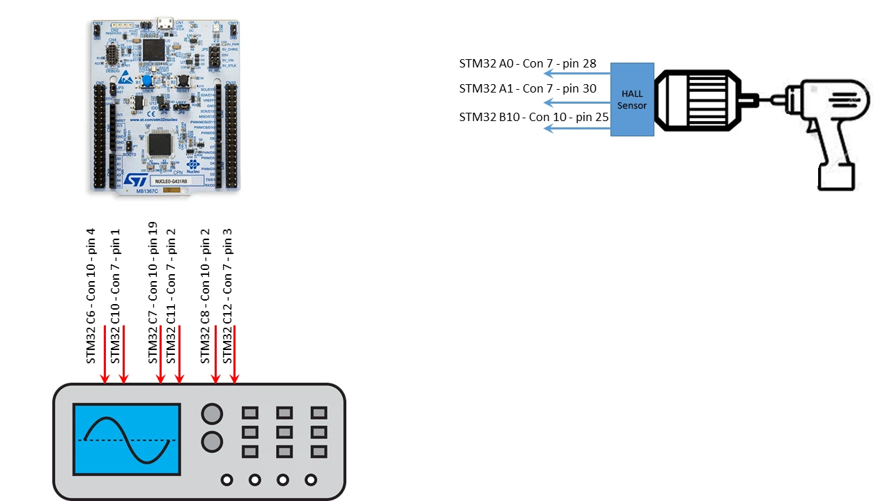

I have made a small test bench setup to test this. I have a NUCLEO-STM32G432RBT. I also have a BLDC with hall sensors attached to it. Currently BLDC is not driven by anything ... the phase connections are unconnected. I attached a drill machine to the shaft of the bldc and made it spin. On the scope i measure the 3 hall sensors and they are as they should be as the shaft is turning.
I am trying to implement what is described in RM0440, on p1159 sec 28.3.29. I have connected the 3 hall sensors to the NUCLEO on Timer2 pins (A0,A1, B10). As the drill machine is turning the hall sensors generate the pulses and drive the NUCLEO. I have configured TIMER8 to be in slave mode, with trigger ITR1 and source.
After CubeIDE generates the code i add following

I am then just connecting my oscilloscope to the NUCLEO to see if PWM are generated and they are NOT. I know i should also enable the Inverted pins, but for now i would be happy just with 3 pins. Any suggestions on what to do?

Could you check that the bit 15 (Master Output Enable) of register TIM8_BDTR (TIMx break and dead-time register) is correctly set.
Do not hesitate to dump all the registers of your timer, I will try to give you some clues.

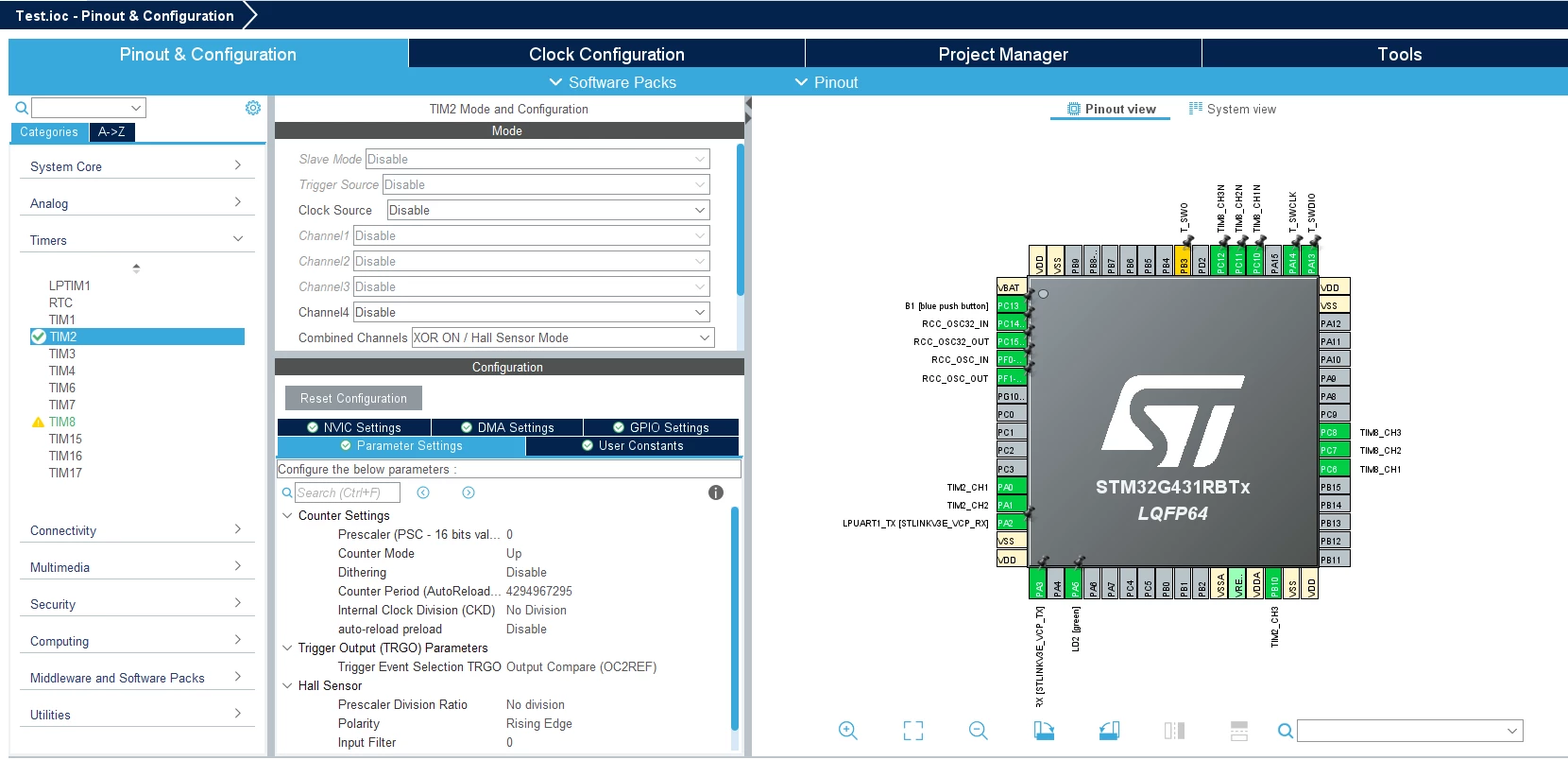

so i have taken your advice. But i wanted to start a bit more simple. On  my P-NUCLEO-IMH03 I implemented my hall sensors on TIM2. The STM32G431 is running on 90Mhz so i first scale down with pre-scaler 900-1, then counter period 10000-1. In the main.c i add lines
__HAL_TIM_ENABLE_IT(&htim2,TIM_IT_TRIGGER);
 __HAL_TIM_ENABLE_IT(&htim2,TIM_IT_UPDATE);
 HAL_TIMEx_HallSensor_Start_IT(&htim2);

i can compile this with no problem and download to mt STM32G4. I then set a break point once get_hall_sensor is called just to see if the "HAL_TIM_TriggerCallback" is executed. It never is. Just to se my TIM2 settings i have put a brak point before while(1). These are the settings
In the ioc, i have enabeled TIM2 global interrupt (NVIC settings).
What am i doing wrong so that TriggerCallback is never called?
