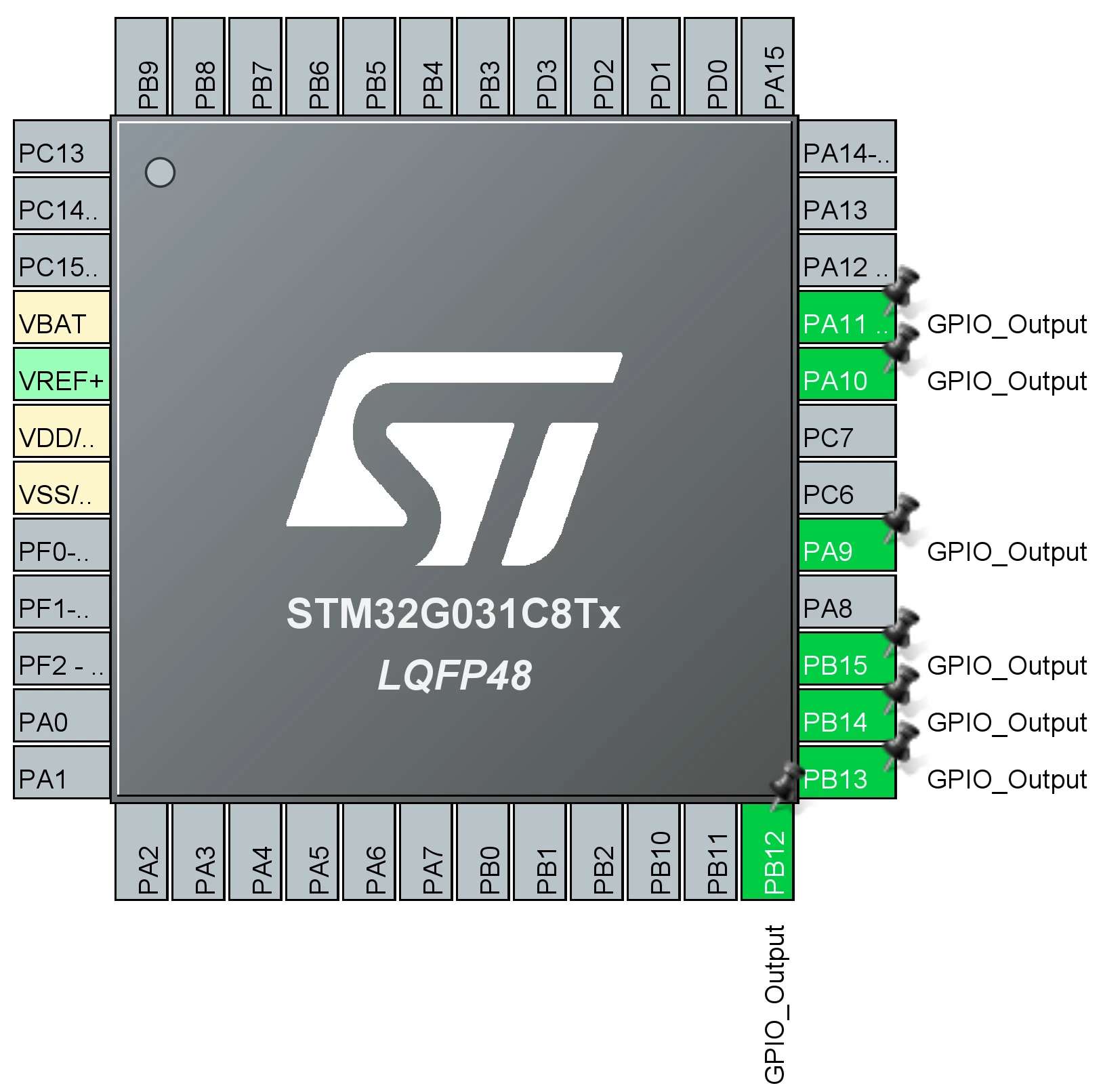

What you could do is, instead of going through TIM1, you could set the output ports used to control the high-side MOSFET and one low-side MOSFET test as normal GPIO outputs and use a simple test loop to toggle the output pins - easier than wrestling with TIM1 settings.
That’s based on what you say about only wanting to test your mosfets and that the production code is tested separately.
As a GPIO its easy to try with different output transition speeds and drive strength, even apply pull up or pull down resistor in the MCU or even use open collector.
Just an idea if it meets your test specs.

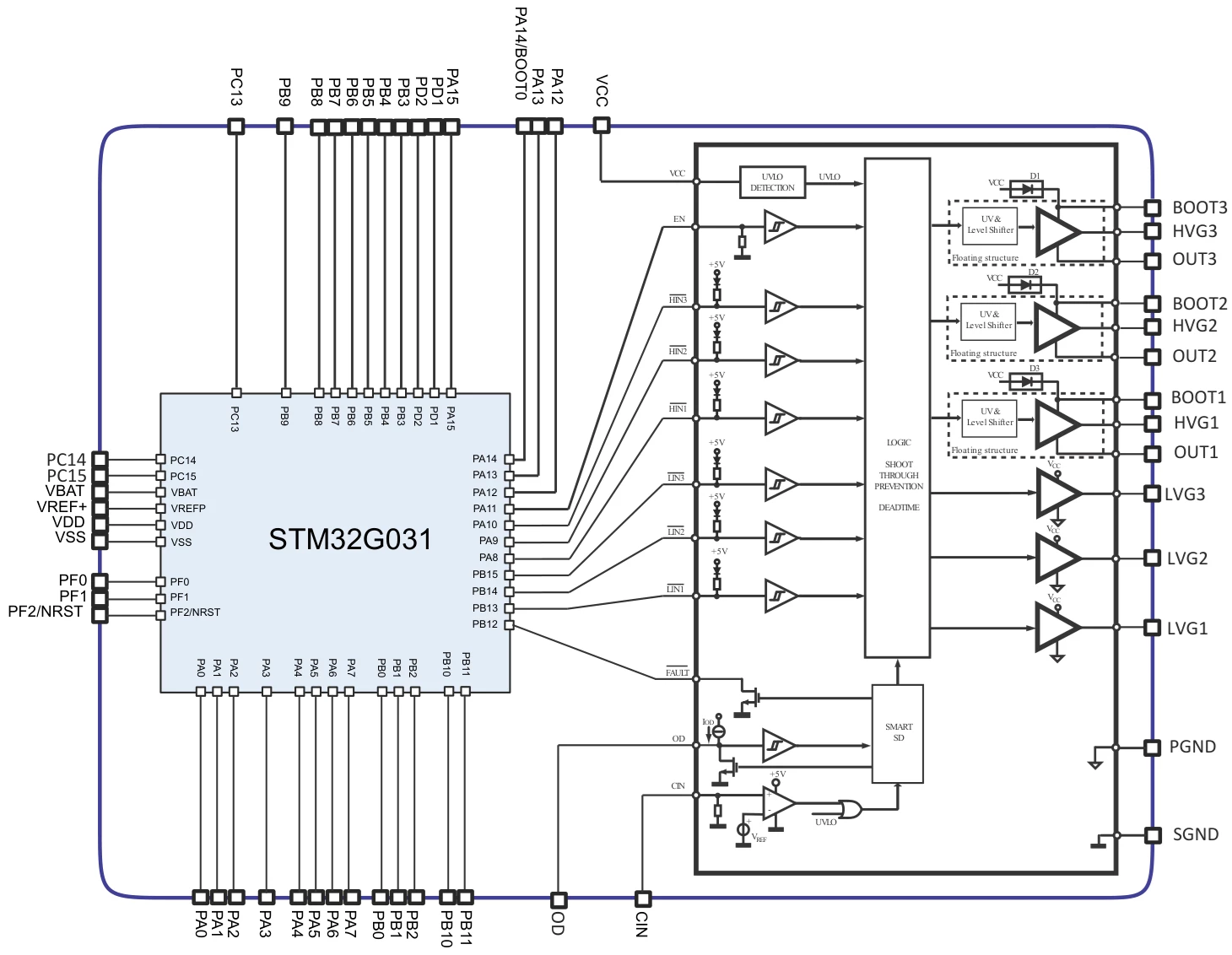

Mathan Raja
Hi @rich.g.williams — I wish I could, but that's not possible on this specific part. This chip (STSPIN32G0602Q) is a system-in-package that combines the STM32G031 core with an integrated 3-phase gate driver on the same die/package. The gate driver's HIN/LIN inputs are internally hardwired to TIM1's channel outputs (PA8/PB13 = CH1/CH1N, etc.) — there's no way to reconfigure those specific pins as plain GPIO and still reach the gate driver, since the driver only listens to the timer peripheral, not arbitrary GPIO toggling. So TIM1 isn't something I can route around here — it's the only path to the gates at all.
To be clear on the actual symptom: TIM1's BIF (break flag) is set and won't clear, which blocks MOE, regardless of channel mode (PWM or forced-output). I've confirmed the break input pin itself (PB12) reads healthy every time I check it, and ruled out every break source I can find in the reference manual (software break, comparator sources — not present on this chip anyway, PVD, lock bits). Still looking for what else could cause this.

rich.g.williams
Senior
​@Mathan Raja
You can access the pins you need and configure them as GPIO output. Please have a look at the following:-
I created a minimal project in ST Core MX with the “bare bones” startup, a summary hinting at the code:-
//GPIO port clock enable register (RCC_IOPENR)    RM0444 page 192
//GPIO port mode register (GPIOx_MODER)
//GPIO port output data register (GPIOx_ODR)
LL_APB2_GRP1_EnableClock(LL_APB2_GRP1_PERIPH_SYSCFG);
LL_APB1_GRP1_EnableClock(LL_APB1_GRP1_PERIPH_PWR);
LL_IOP_GRP1_EnableClock(LL_IOP_GRP1_PERIPH_GPIOB);
LL_IOP_GRP1_EnableClock(LL_IOP_GRP1_PERIPH_GPIOA);
LL_AHB2_GRP1_EnableClock(LL_AHB2_GRP1_PERIPH_GPIOC);
LL_AHB2_GRP1_EnableClock(LL_AHB2_GRP1_PERIPH_GPIOA);
LL_GPIO_ResetOutputPin(GPIOB, LL_GPIO_PIN_12);
LL_GPIO_ResetOutputPin(GPIOB, LL_GPIO_PIN_13);
LL_GPIO_ResetOutputPin(GPIOB, LL_GPIO_PIN_14);
LL_GPIO_ResetOutputPin(GPIOB, LL_GPIO_PIN_15);
LL_GPIO_ResetOutputPin(GPIOA, LL_GPIO_PIN_9);
LL_GPIO_ResetOutputPin(GPIOA, LL_GPIO_PIN_10);
LL_GPIO_ResetOutputPin(GPIOA, LL_GPIO_PIN_11);
GPIO_InitStruct.Pin = LL_GPIO_PIN_12;
GPIO_InitStruct.Mode = LL_GPIO_MODE_OUTPUT;
LL_GPIO_Init(GPIOB, &GPIO_InitStruct);
GPIO_InitStruct.Pin = LL_GPIO_PIN_13;
GPIO_InitStruct.Pin = LL_GPIO_PIN_14;
GPIO_InitStruct.Pin = LL_GPIO_PIN_15;
GPIO_InitStruct.Pin = LL_GPIO_PIN_9;
LL_GPIO_Init(GPIOA, &GPIO_InitStruct);
GPIO_InitStruct.Pin = LL_GPIO_PIN_10;
GPIO_InitStruct.Pin = LL_GPIO_PIN_11;
All it is is turning clocks on and using MODER register to set pins as outputs, using ODR registers to toggle them.
You could use ODR registers to toggle the seven driver pins.  You could load a very basic program into Flash or even RAM either by using STLINK or the built in bootloader. I have no idea how you would want to toggle the pins I just assume a simple continuous loop could cycle through GPIO pins PA11, PA10, PA9, PB15, PB14, PB13, PB12 in a safe sequence for your tests.
You could also configure PB12 as a GPIO input with firmware pull up and then poll it to terminate the test immediately if a fault arose signalled on PB12.
The core SYSCLK runs at 16MHz from reset (from the internal RC oscillator HSI) from reset and can stay at 16MHz for the tests, no need to configure the PLL.
Hope that helps, let me know if I can help any further.

Mathan Raja
Hi @rich.g.williams,
Thanks for the diagram — you're right, I was wrong earlier. HIN/LIN are bonded directly to the MCU pins, not to TIM1 specifically, so plain GPIO works fine on this part. I tried it.
Setup: Reconfigured PA8/PA9/PA10 (HIN1/2/3) and PB13/PB14/PB15 (LIN1/2/3) as GPIO_Output (push-pull, no pull, idle HIGH = off, matching active-low logic), toggled them directly with HAL_GPIO_WritePin(), no TIM1 involved at all. PA11 (EN_GATE) stayed GPIO_Output, initial low. PB12 (FAULT) stayed GPIO_Input with pull-up, unchanged.
Result: Same as before. Low-side works perfectly every time (output reads 0V). High-side still doesn't turn on — output stays stuck at ~14V instead of rising to the bus voltage, tested at both 90V DC and 115VAC.
So this rules out TIM1 completely — the problem isn't the timer or my config, it's something in the driver's high-side stage itself, even though HIN is being driven correctly, EN is on, FAULT is clean, and the bootstrap cap charges fine beforehand.
Thanks for pushing me to test this — good to have TIM1 ruled out for certain now.

Mathan Raja
Solved. Thanks, your question about "prerequisites for the high-side drivers" was the key.
Root cause: the high side runs from the bootstrap capacitor, and my test held it ON statically for seconds.
1. The bootstrap cap discharges (VBO drops below the ~7.5 V UVLO), so HVG switches off.
2. Per DS14512 section 6.1.4, after VBO UVLO recovery, HVG stays OFF until the next HIN transition. In my sequence, HIN was set before EN went high, so the driver never saw an edge.
Fix:
- Enable EN with all inputs OFF.
- Precharge the bootstrap: low side ON for ~5 ms.
- Then drive HIN low (a fresh edge).
- For long holds, refresh every ~10 ms: HIN off, LIN pulse (~0.5 ms), HIN on.
With this, all three high-side FETs switch correctly at 115 V, and our EOL power-stage test now passes.
