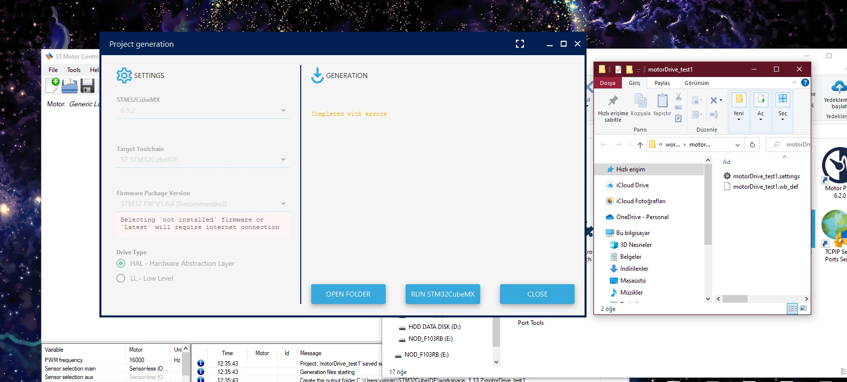

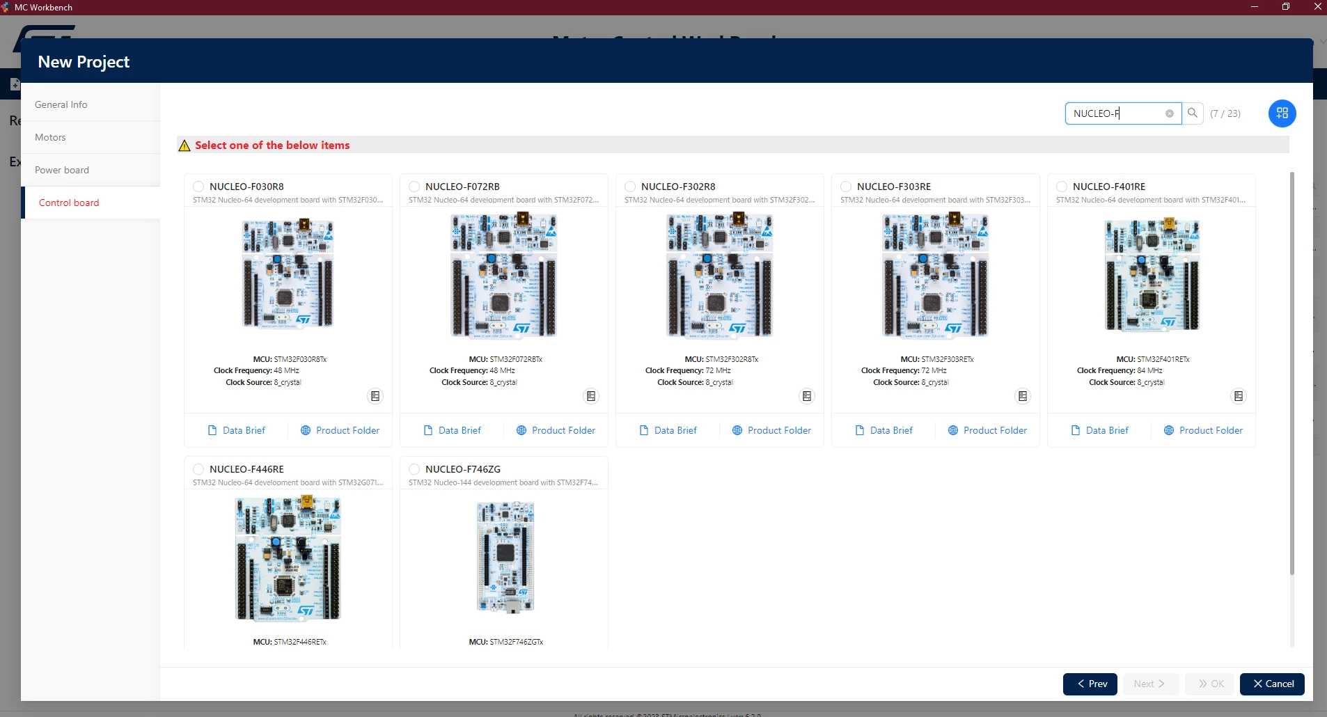

There is no NUCLEO-STM32F103RB board in SDK 6.0. How can I add this board on SDK 6?
Osman_Faruk_Avc_0-1698787759564.pngPicture 1 SDK 6
Osman_Faruk_Avc_1-1698788186795.pngpicture 2 SDK 5.4.8
I want to drive a BLDC motor via IHM16M1 with the newly purchased nucleo-stm32f103rb board. But the control cart is not here. Old version SDKs are also available as XML files(f103rb). SDK 6 introduced the .json extension. And it can't generate code in older SDK versions.
Can anyone help me drive the motor?

    Hello Osman_Faruk_Avcı,
    Unfortunately, the STM32F103 MCU is no longer supported by our MCSDK. If you want to work on the NUCLEO-F103RB board, you need to use MCSDK version 5.4.8 which is the last version supporting F1 MCUs.

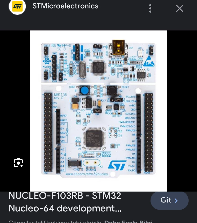

    what stm32f103 card ?
    October 31, 2023
    Stm32f103rb board
    AScha.3
    October 31, 2023
     nucleo or what ?
    show pic...name of cpu is not enough.
    October 31, 2023
    Yes nucleo.
