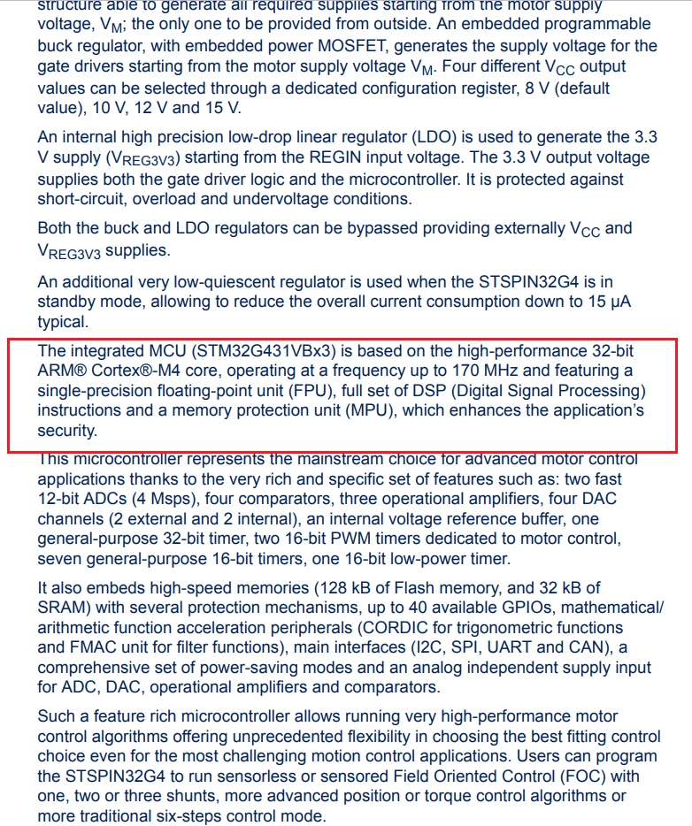

The STSPING4 package has 64 pins, but after being generated using MC Workbench, it becomes 100 pins?
After generating STSPING4 using MC Workbench and opening it with CubeMx, it becomes an STM32G431VBTx chip? There are 100 pins, which do not match the packaging of STSPING4. The generated code cannot be used either.
