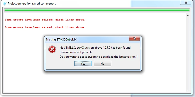

I have installedthe motor control workbench and STM32CUBEMX. However, I can not generate the code for motor control. The error is, NO STM32CUBEMX version above 4.0 has been found. Is there any version of cubemx which is newer than 4.0 ?
When I remove the STM32CUBEMX, I am getting the same error, too. Therefore, I came to the point that the motor control workbench MCSDK 5.0.3 and 5.0.2 do not see the latest version of cube mx, which is 4.0.
The screenshot of the error can be found in attached file.
Any help, idea, suggestion and advise would be appreciated.
Thanks a lot dear ST community members....
***I have gone through the installing steps for my all computer with windows 7 and 10 (32 and 64 bits). All results are the same.***

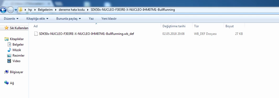

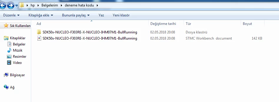

gokay aygok
Posted on May 02, 2018 at 19:16
Hello dear
PALANO.Carmelo_Marce
I am so happy to see your reply.
There is no such a file unfortunately.
What I have can be seen in the screenshots I will just share.

MAli.2
Visitor II
Hello. I had the same problem. Then, I fixed it by changing operating system language. If your OS has Turkish language, you get that problem. OS language must be English. Problem solved.
