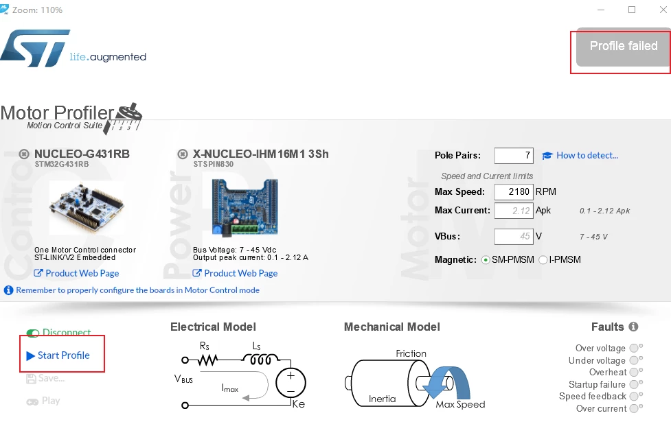

The board is p-nucleo-ihm003 included STM32G431RBTx MCU and X-NUCLEO-IHM16M1 POWER, I open the motor profile 5.4.5, click the button named "connet", it works.And then input 7 poles,and click the button named "start profile",why it shows "profile fail

If your point is still pertinent, I made a test with FW5.4.8 version and same boards/motor and I was able to profile the motor.
Could you please verify that on IHM16 board, jumpers/connections fulfill the "FOC(3Shunt)" requirement as mentioned in User Manual UM2415 "Table 2. X-NUCLEO-IHM16M1 expansion board configuration based on the algorithm used"?
