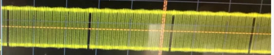

I am running the motor control workbench B-G431B-ESC1 board. The systick fires at every 2K frequency as per the user manual and the waveform matches when i toggle, but the problem is sometimes it misses as shown
I want to debug and find out why it misses those timings in between. Please suggest how do i find out? I am also running CAN in parallel at 500KBPS.

    I modified the algorithm of CAN and behavior is ok now, i mean i transmit 3 messages at one time, after 1 sec another 3 messages with total of 12 messages
    1st sec -> 3messages
    2nd sec -> 3 messages
    3rd sec -> 3 messages
    4th sec -> 3 messages
    repeat like this.

    What is the effect of disabling CAN?

    Sorry for late response yes it is because of CAN task, how do i solve the problem? I will try to reduce the code in CAN ISR and put it in while(1).

    No problem. Have you considered generating your waveform directly with a TIMER routed to GPIO or if the waveform is a bit more complex use DMA to drive GPIO and use a timer to drive the DMA timing? That way CAN ISR will not interfere with waveform generation. If needed I can provide an example code.

    That said, if your "systick" is the normal ARM/STM32 systick timer, it typically defaults to the lowest interrupt priority.  You can change that and make it a higher priority (lower numeric value) than then CAN interrupts.  Presuming of course that the CAN interrupts can tolerate some delay when the systick interrupts them.  Or use a different timer (with a higher interrupt priority than the CAN interrupt) for that purpose.
    Is the waveform you showed just "toggle a pin" inside the systick ISR to show when it is missed (or delayed), changing the priority may be all that is needed.  If that is indeed a waveform needed by your system, then changing to DMA/GPIO instead of code in an ISR as @Johi suggested might be needed.

    My main concern is SysTick_Handler is missing timing in between. The code is as below.

    What's happening if you turn of other interrupts, or at least do nothing (except setting a flag maybe) in the interrupt handlers?

    BTW, the skipped pulse on the scope looks quite regular, maybe you show the interrupt handler where you toggle the GPIO.
    And have you reduced the other interrupts' priorities?

    I have shown the code in my 2nd post. I have put the CAN interrupt lowest but unfortunately I am using the Systick as the base time for CAN as well do I need to use other timer. There is huge code in CAN and transmitting lot of messages around 9 with periodicity of 1 sec.

    There's a lot happening in your SysTick_Handler, why that divider?
    That makes me assume that you are using a very high SysTick frequency, which again means that this interrupt handler is called too often. It should be good enough with 1 kHz for most applications.
    And yes, try using another timer as base time for CAN.
    You are using it for timeouts, message scheduling or what?

    what's the time between the dropped pulses?
    Maybe that might tell you something.
