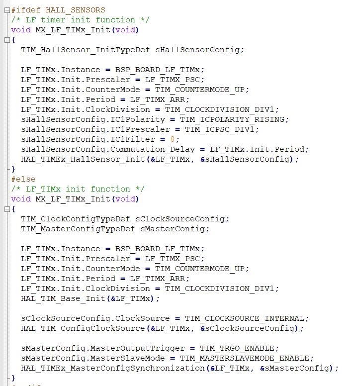

  1. As you can see the below picture, in the hall sensor case, there is no initialization for master/slave in commutation event (main.c). Is this code right or not? I think this code is not true.

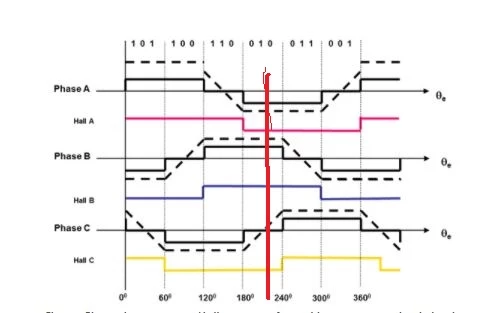

3 . For example, when Input capture happens HAL_TIM_IC_CaptureCallback() is called , assume that hall status = 2, it means as case 2 in MC_SixStep_NEXT_step(), next_step_pos = 1, this function sets up the CCR1 = pulse_value. As the below picture, I think we should set up the CCR2 = pulse_value, is that correct? For my understanding, after the commutation delay, HAL_TIM_OC_DelayElapsedCallback() is then called. At that time, next_step_pos = 2. And then MC_SixStep_TABLE(2) is called, in case 2 in MC_SixStep_TABLE(2) set up CH1, and CH3. It made me so confused. May you explain to me? Thank you so much.

  1. Master/slave between the two timers is "hidden" into the "HAL_TIMEx_HallSensor_Init(&LF_TIMx, &sHallSensorConfig)" function

  3. In Hall sensor mode the pulse value is configured during the HAL_TIM_IC_CaptureCallback (). The HAL_TIM_OC_DelayElapsedCallback () operates during startup phase only in case of unexpected timout of the Hall sensor timer. In fact the very first conditioning here checks the Hall_ok status condition.
