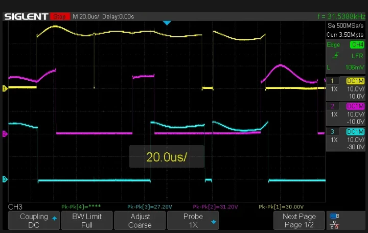

We've designed a STSPIN32F0251-based motor driver board, but when running the 6-step firmware algorithm, the motor aligns and then vibrates with a high-pitched sound. When we check the state-machine, we can see it reaches the RUN state after executing ALIGNMENT.

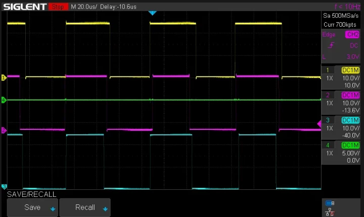

We probed the inverter output phases on both our custom board and the EVSPIN32F02Q1S1 evaluation board, observing significant differences in pulse width and voltage levels, despite using:
- The same user code
- The same PSU
- The same motor & encoder
Scope Captures
Custom Board:
- Channel 1 = OUTA
- Channel 2 = OUTB
- Channel 3 = OUTC
EVSPIN32F02Q1S1:
- Channel 1 = OUTA
- Channel 2 = OUTB
- Channel 3 = OUTC
- Channel 4 = Current Sense Amplifier Output
Board Modifications
To match the EVAL board, we made the following PCB modifications:
- RES5 pin grounded via flywire.
- V+ and V- on U2 were corrected by lifting the pins and flywiring to the correct nets.
There are more differences between the two boards, I detailed them here below and attached the schematic PDF.

Questions
- How should we interpret the waveform from our custom board? What steps should we take to align it with the EVAL board’s output?
- Why does the EVAL board’s current sense amplifier output appear as a flat DC signal? Shouldn’t it show a ramp-like waveform?
