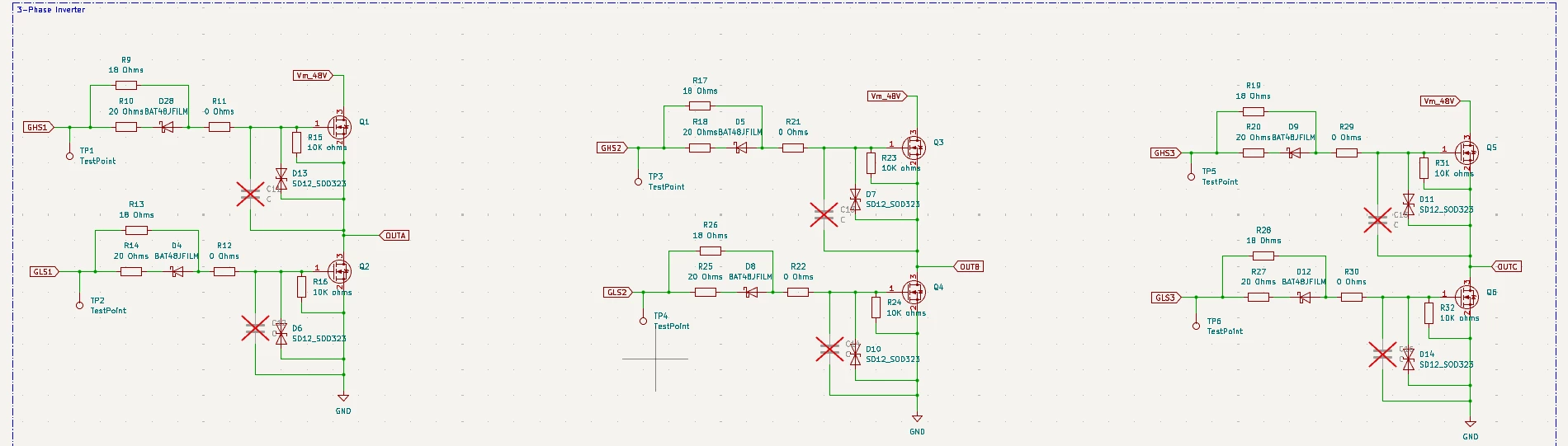

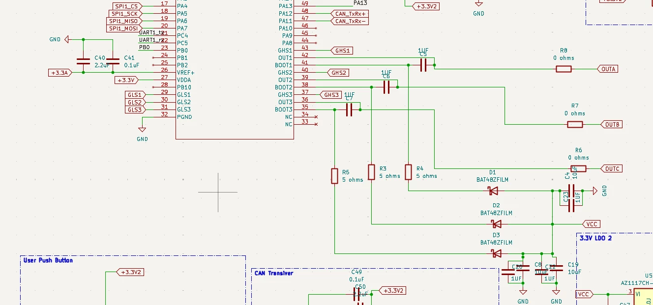

I’m working on a project using the STSPIN32G4 and running into an issue where the MOSFETs are not switching as expected. I’d really appreciate some guidance from the community.
Setup:
  • MCU: STSPIN32G4 (integrated STM32G4 + gate driver)
  • Power stage: 3-phase inverter using N-channel MOSFETs
  • Power supply: 48V
  • Control method: Just attempting to drivethe Inverter
  • Firmware: Own
Problem:
  • The MCU is running and I can confirm firmware execution via debug.
  • The MOSFETs are not turning on — no switching on the half-bridges.
  • Gate driver outputs appear to stay low (no high/low drive pulses).
What I’ve Checked:
  • VBOOT and VCC supply rails are within spec.
  • EN/FAULT pins are pulled correctly(High).
  • PWM timer configuration looks fine in CubeMX.
  • Dead-time insertion is enabled.
  • No over-current fault is being signaled (nFAULT pin is inactive).

Thank you for your reply. The problem was TVS diodes.
