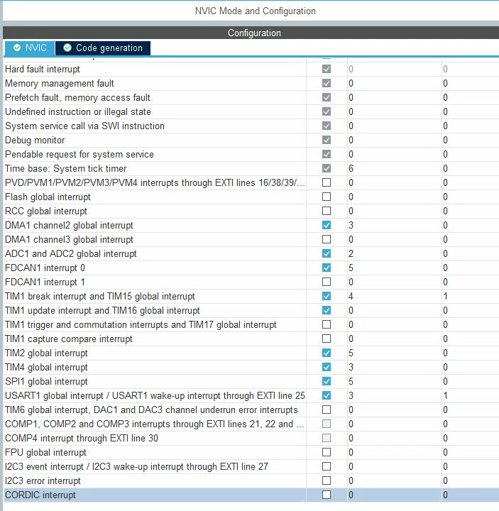

Below is the current NVIC table. I am using an interrupt for the encoder over SPI, but I might change that to DMA if it helps.
So the hypothesis right now is that overheating is causing my troubles. But it could be anything really, with all sub-systems running together. Running a separate code with encoder over SPI and CAN Bus is very robust. If I uncomment this line out MX_MotorControl_Init(); things get very hot ;)

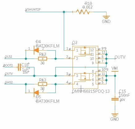

0693W00000LxvWkQAJ.jpgMosfets:
  • Vgs(th) = 1 to 3V, Id = 250uA

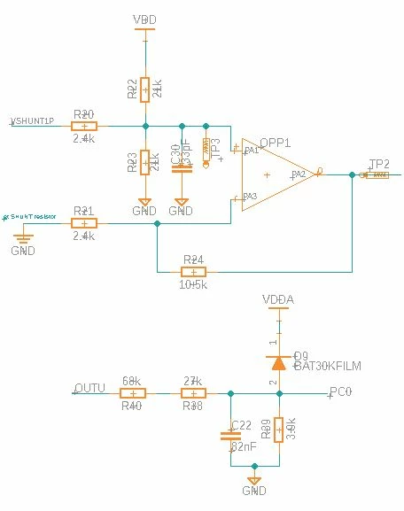

Power Sensing (3 Shunt):
0693W00000LxvWpQAJ.jpgPower consumption/Current Draw:

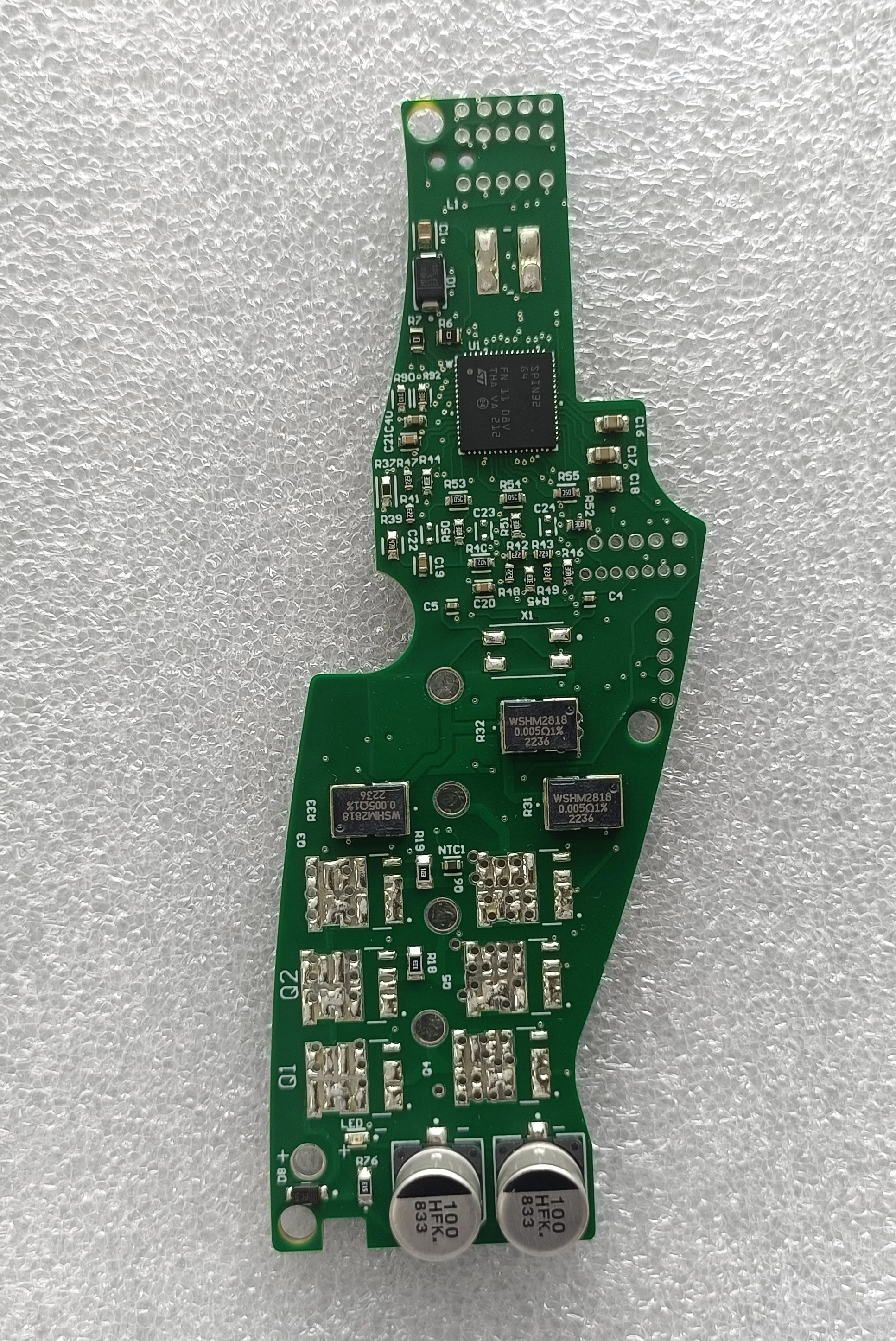

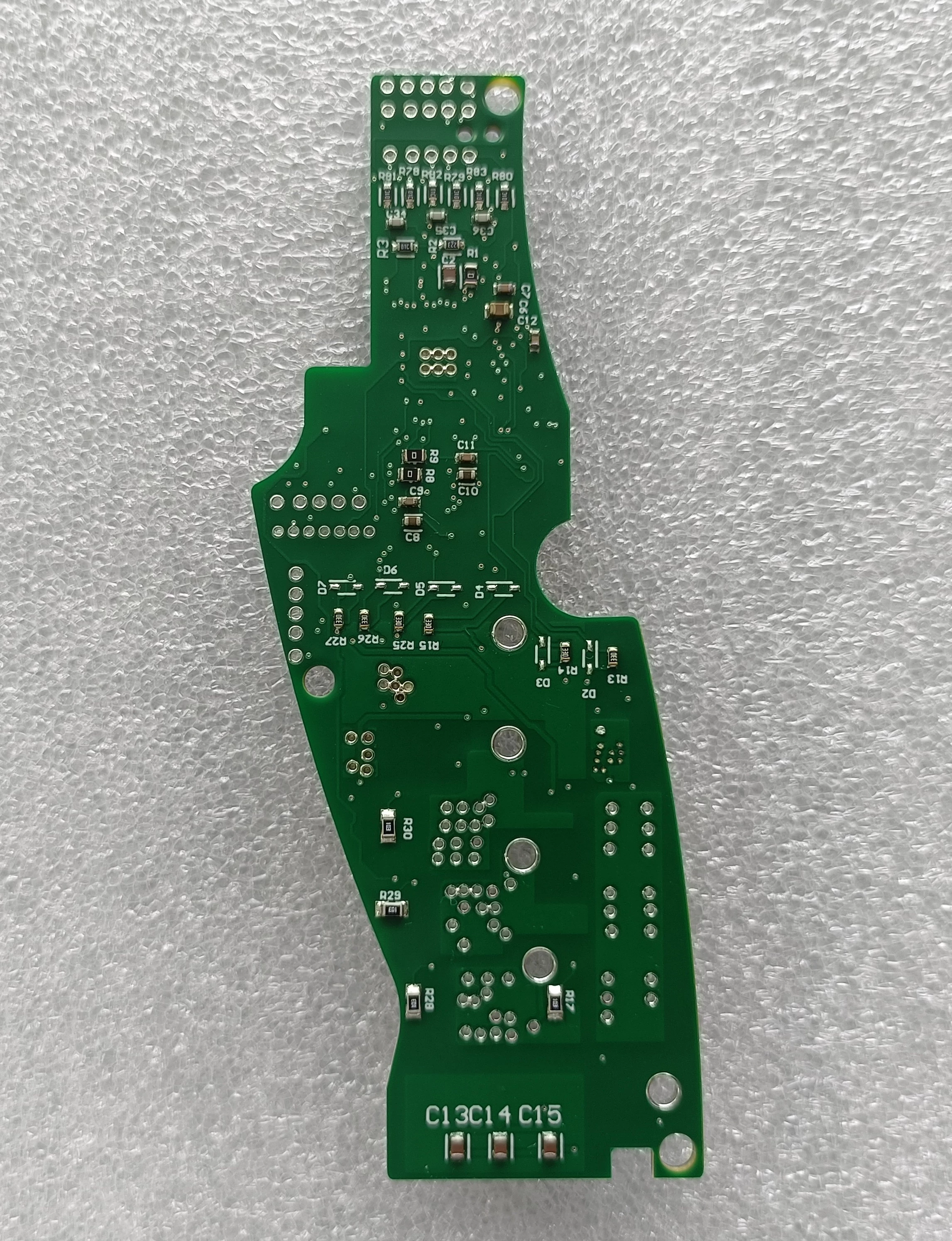

ABuga.1
July 26, 2023
Hi @PCama.1,
Were you able to solve your problem? I am also facing a heating problem with the controller.
I have a problem with my custom stspin32g4 board ( see photos attached).
I have tested with my MOSFETS and buck converter inductor.
The STSpin32g4 controller gets hot once I connect my MOSFETs, especially the GLS3 MOSFET.
The motor pilot goes to the STOP state whenever I click on start on the motor pilot, and the controller gets hots ( see video attached)
However, whenever I remove the MOSFETs, it goes to the START state on the motor pilot, and the controller doesn’t get hot.
I have checked for partial contacts and cannot find any within the PCB circuit.
My circuit was made exactly from the EVSPIN32G4 schematic.
I would be very happy if you could link me to the technical team of STSPIN32.
Thank you very much,
Aminu Bugaje
