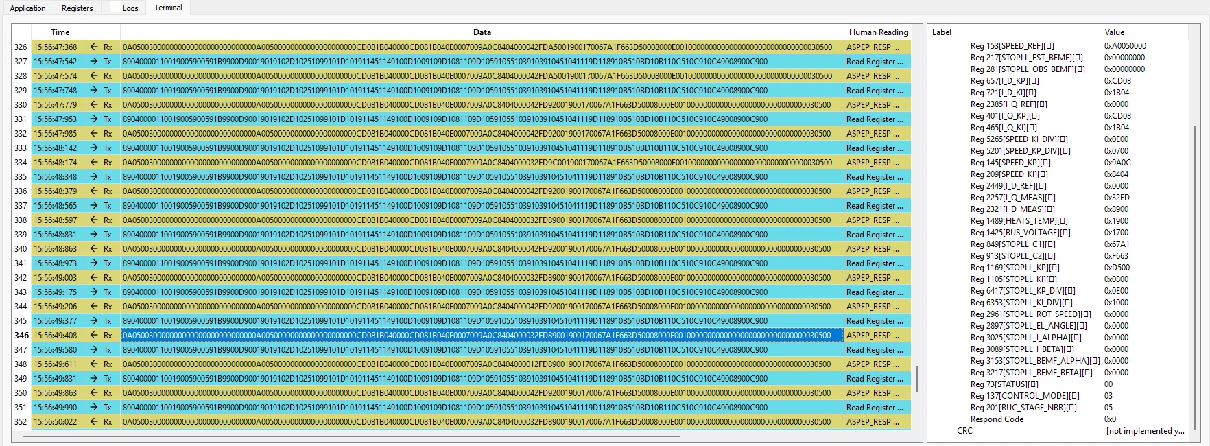

Hello ​@Vasalic,
Refer to the response format.
On MC Pilot Terminal display:
