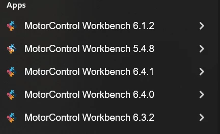

Apr 27, 2026 09:21 UTC
Hello @Raj6135,
Project has been generated with MCSDK6.4.2, but on your ioc file "ExtraMW.MotorControl.Root=MCSDK_v5.4.8-Full/MotorControl" and in the project directory there is MCSDK_v5.4.8-Full.
Did you modify the wb2mx.properties file?

Raj6135Author
Apr 27, 2026 10:20 UTC
Thank you for the reply, @GMA. I did not modify any project files; however, there are multiple versions installed on my computer (as listed in the attached image).

GMABest answer
Apr 27, 2026 13:21 UTC
Hello @Raj6135,
Does MCSDK_v6.4.2-Full folder present in ~/STM32Cube/Repository? If not, uninstall and reinstall MCSDK6.4.2.
Generate a new project (do not use a previously use directory).
Generated .ioc file should contain "ExtraMW.MotorControl.Root=MCSDK_v6.4.2-Full/MotorControl".
STM32CubeMX v6.17.0 is recommended for MCSDK6.4.2 (refer to MCSDK release note for more details).
