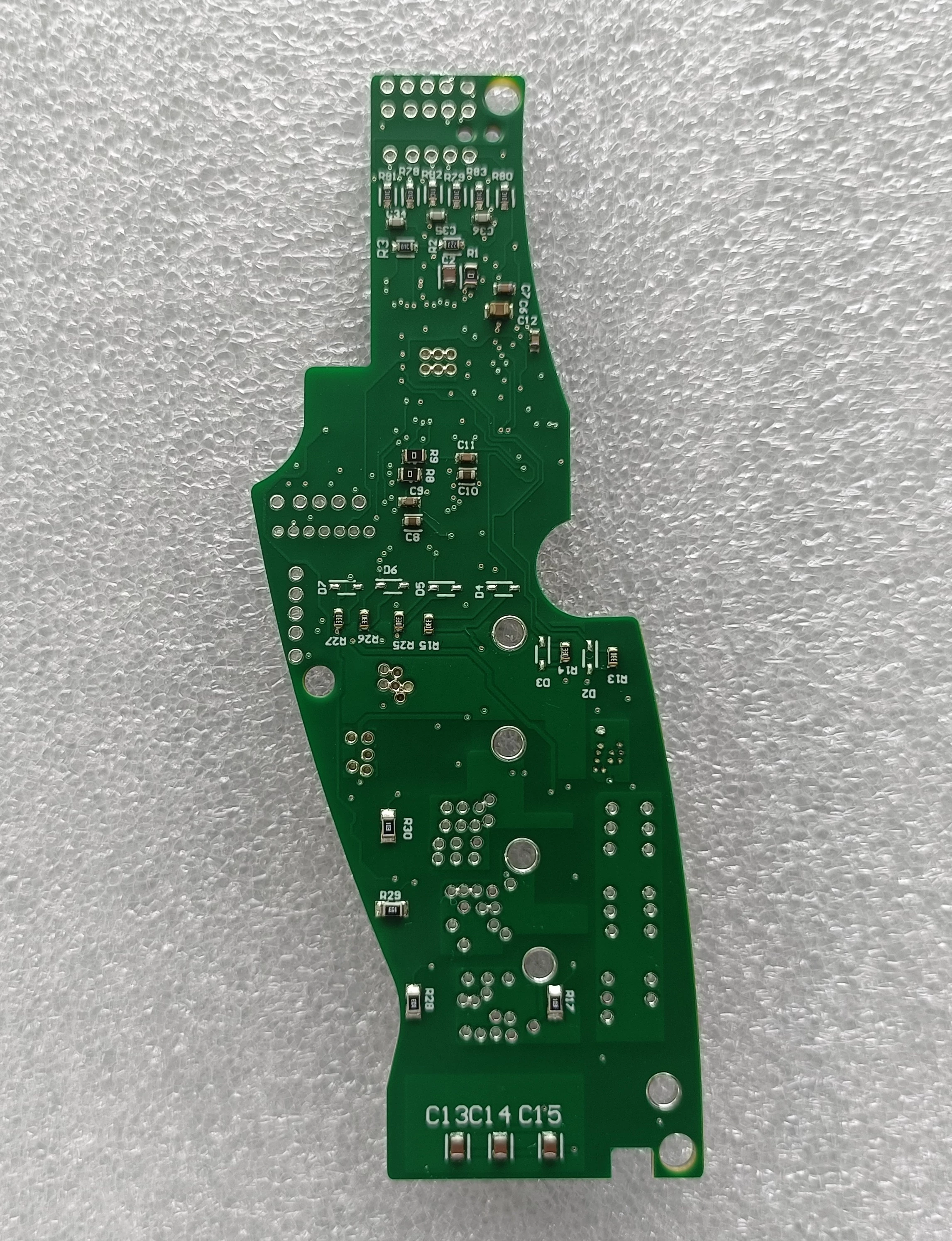

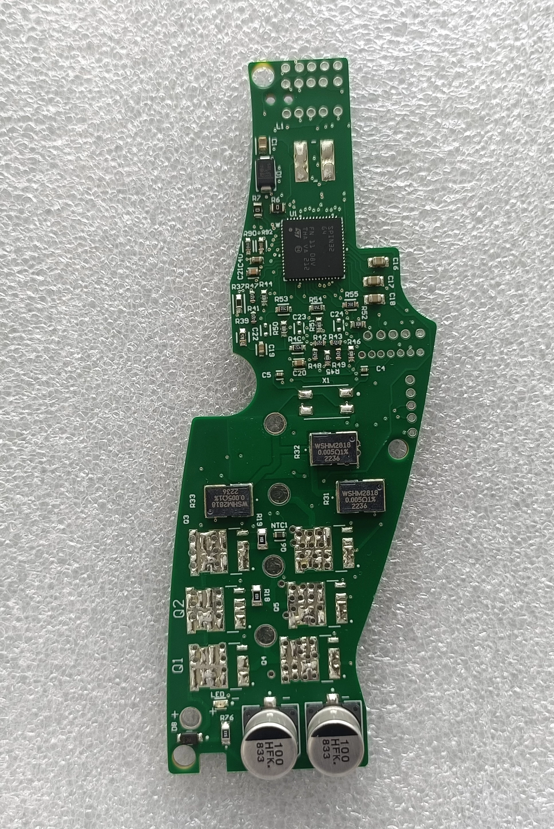

I have a problem with my custom stspin32g4 board ( see photos attached).
I have tested with my MOSFETS and buck converter inductor.
The STSpin32g4 controller gets hot once I connect my MOSFETs, especially the GLS3 MOSFET.
The motor pilot goes to the STOP state whenever I click on start on the motor pilot, and the controller gets hots ( see video attached)
However, whenever I remove the MOSFETs, it goes to the START state on the motor pilot, and the controller doesn’t get hot.
I have checked for partial contacts and cannot find any within the PCB circuit.
My circuit was made exactly from the EVSPIN32G4 schematic.
I would be very happy if you could link me to the technical team of STSPIN32.
