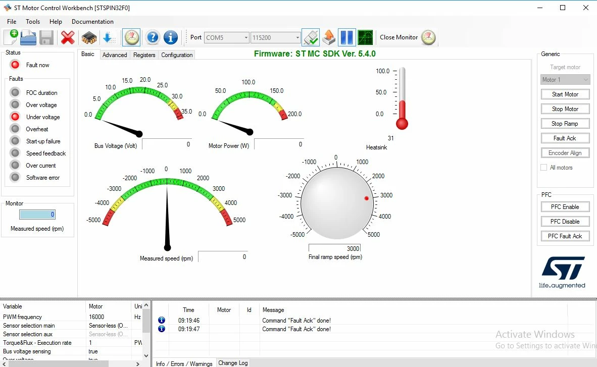

STSPIN32F0A VDC BUS Voltage not sensed in the Motor Control Workbench.
I am using a custom board with STSPIN32F0A microcontroller. After assigning pins in the Motor control workbench, I am generating the code. Then I dump the code to the MCU by IDE.
After that 12VReg starts.
To test the motor, I go to Motor control Workbench--> Monitor section. Then I initiate UART communication and the device gets connected.
But here the "Under Voltage fault always persists. Please check the image attached below."
Note: I apply 12V input to run the Motor. Motor Used : Bull Running BR2804-1700kv
Please help me solve this problem. I have been stuck over here for more than 20 days.

@Ritul Shah​ I have some questions to better understand your setup: If I understood well, you a re using a custom board: which is the GPIO line you are using for reading the bus voltage ? Is it the PB1 as in the STSPIN32F0A evaluation board ?
Which are the values of the resistors for the bus voltage divider ?
Did you tried to sense the line used for bus monitoring with a digital multimeter, just to check whether the expected voltage is present ?
I'm just trying to figure out if it is a hardware issue or a firmware issue...

Hello Dario,
I have been able to solve the issue.
I had a problem with UART communication, which created the problem.
