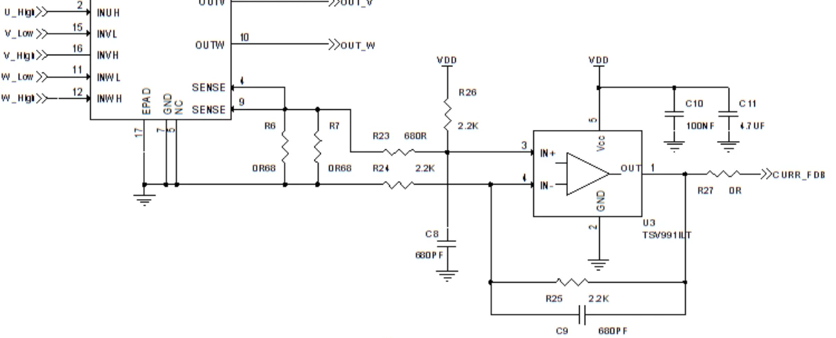

STSPIN230 Evaluation board -> X-NUCLEO-IHM11M1
In X-NUCLEO-IHM11M1,
1) What is the Formula to convert the Current feedback Output from OPAMP ?
2) What is the relation of the voltage read in current Feedback pin and the motor Current value?

Hello @NIVI ,
In the attached file you will find all the necessary information for the opamp on ihm11, in the picture below, how the calculations are made:
Regards
