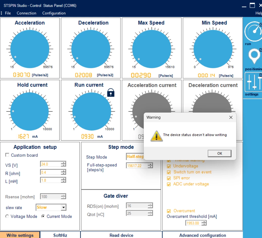

STSPIN Studio --- Stepper Motor 24BK20-30 --- NucleoF401RE
I have the above subject powered with 24V, 3A power supply.  The motor is not loaded.  I keep having issues trying to write to the device.  How do I get this warning to not appear and why is it appearing?

Hello @SWenn.1 ,
the motor must not be in motion to write the parameters.
The STSPIN Studio is an evaluation software, it does not output a project for STM32.
