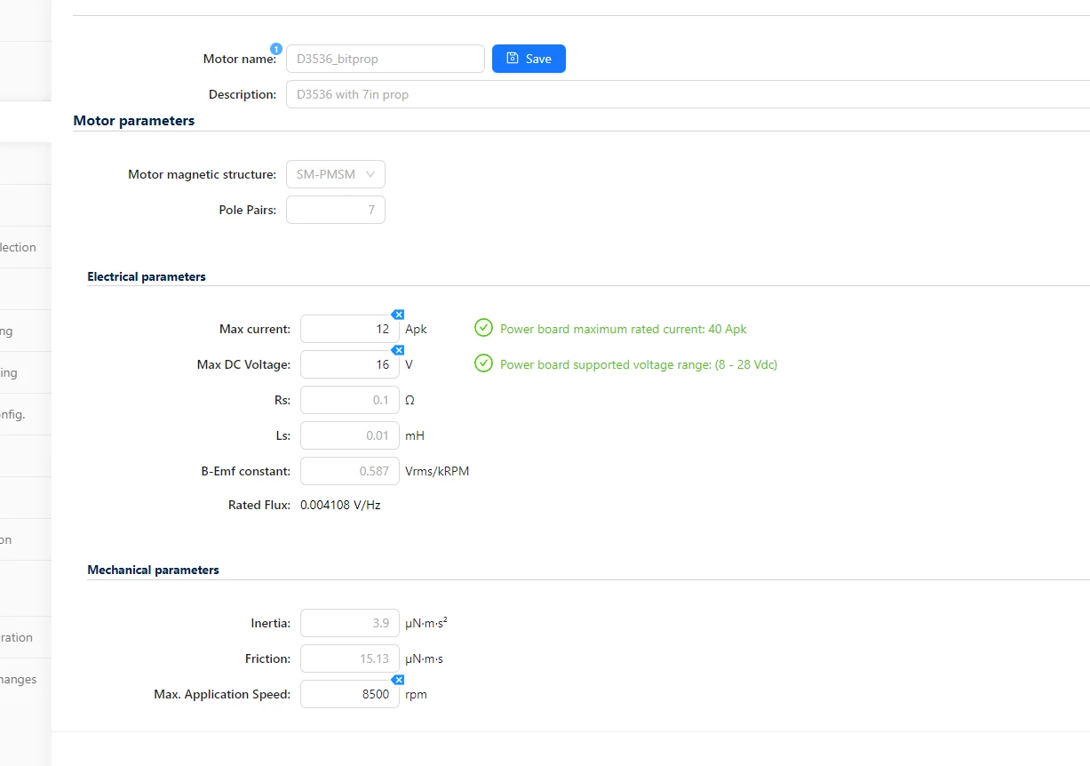

Motor: rs2205: very simmilar spec to Bullrunning motor (7PP, 0.1ohm, 0.01mh, etc....)
Hi. I created a FOC app with my controller+driver+motor above.. When I try to start it, the motor spins up just fine, but I get a "speed feedback" error.
-This is a profiled motor
-The only changes I made to the application was to disable driver protection feature

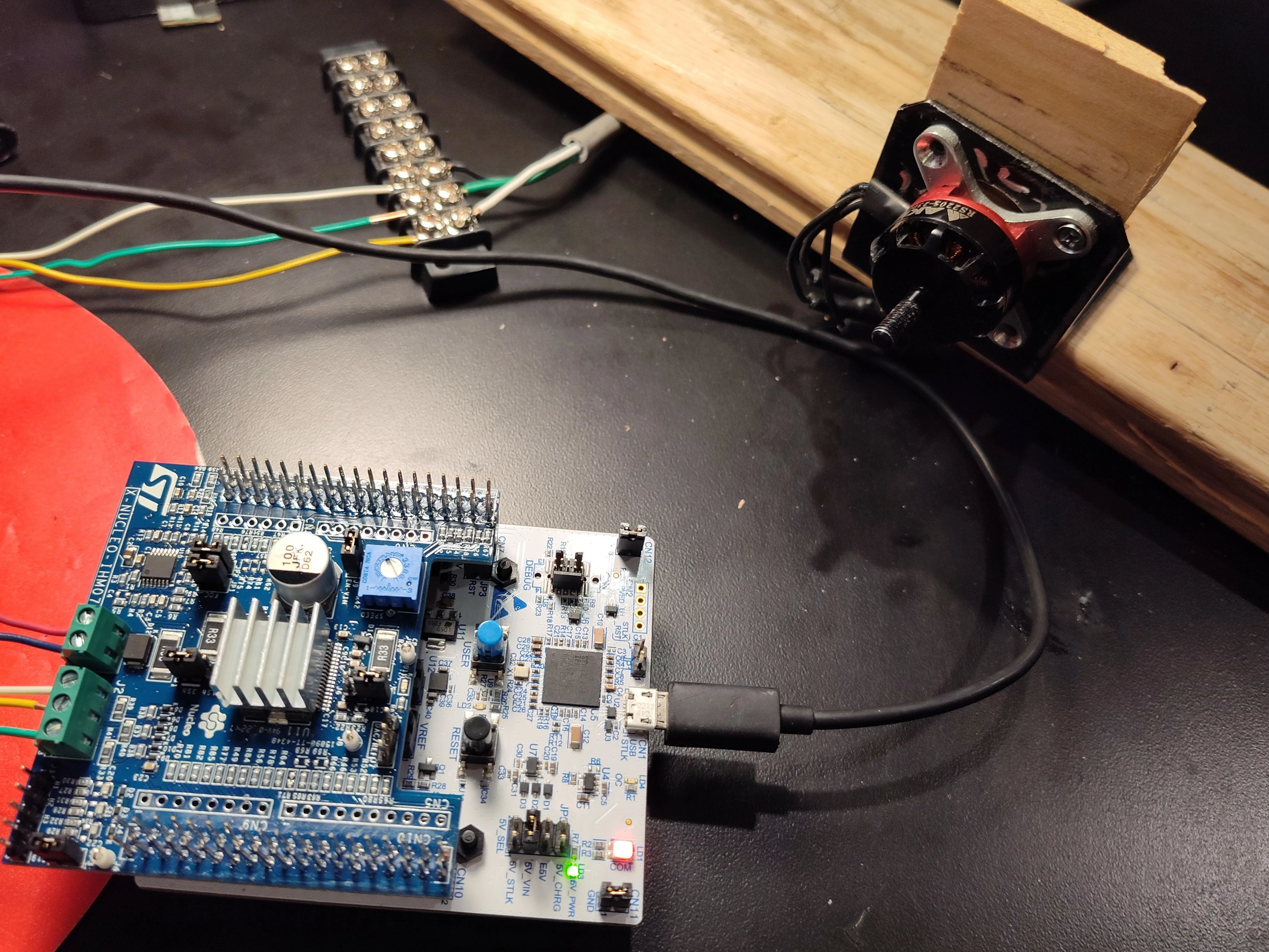

HW setup:
Motor config:

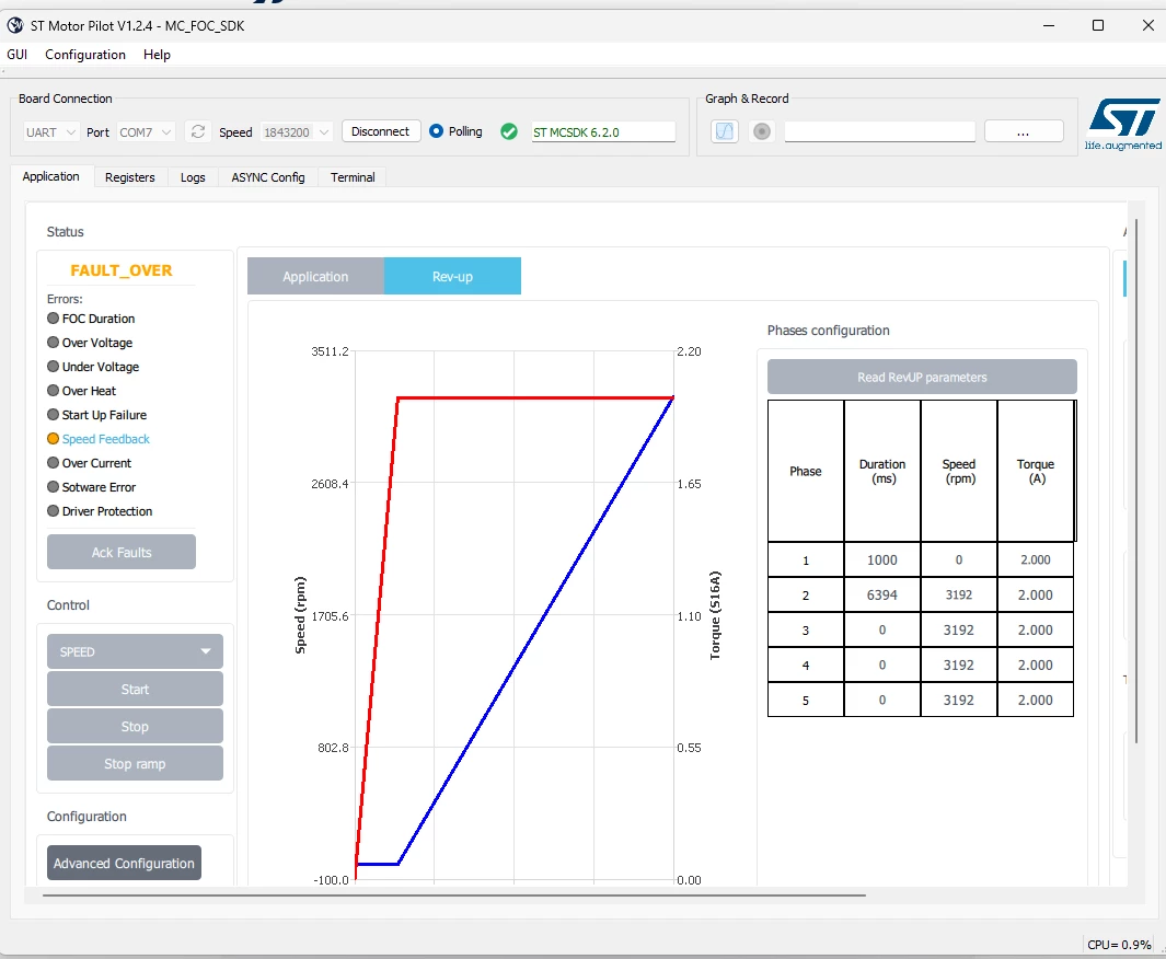

Error:

    Could you please tell us why you decided to remove the driver protection on the IHM07 ? If I recall correctly, there is no OverCurrent Protection on the IHM07, so the Driver Protection is the only feature protecting your board in case of overcurrent.
    Concerning your Speed Feedback issue, I would at first glance recommend you to increase your PWM frequency since you are using a low-inductance motor.
    If this does not fix it, then have a look at your currents and estimated speed. If they are too noisy, try reducing your PLL G2 gain, or play a bit with the Speed Kp & Ki gains.

    -Regarding PID tuning... Doen't the speed feedback error mean that the issue was detected in the spinup (before PID loop starts)??
    -Speed detection is accurate and very stable duinng the spin-up
    -I tried 32000 and 40000 with no luck. Part of the problem is I don't know enoujgh about the sensorless FOC speed detection algorithm, can you refer me some docs on it?

    You can find information on the Speed Feedback error in the MCSDK's documentation : while in WorkBench -> Click on About -> Documentations -> Documentation -> User Manual -> Firmware errors. It explains when and why Speed Feedback errors occur. In your case, I believe it happens during the SWITCH_OVER state. Maybe increasing the range of the acceptable speed variance will do the trick, although you will have to check the stability yourself to see if it meets your needs.
    Also, I have looked at your images again, and when checking your speed ramp, I believe the targeted torque may be a bit too high. The IHM07 output RMS current is limited to 1.4A (following datasheet), which is lower than what you input, so concerning the driver protection, the only thing I see is a start-up current ramp that would be too high.
    If this does not fix it, then maybe the error given by the driver is not an overcurrent. However we currently have no solution for such behaviors (apart from removing the driver protection as you did). Maybe try to get an insight on what is happening from the range of possible driver errors ?
