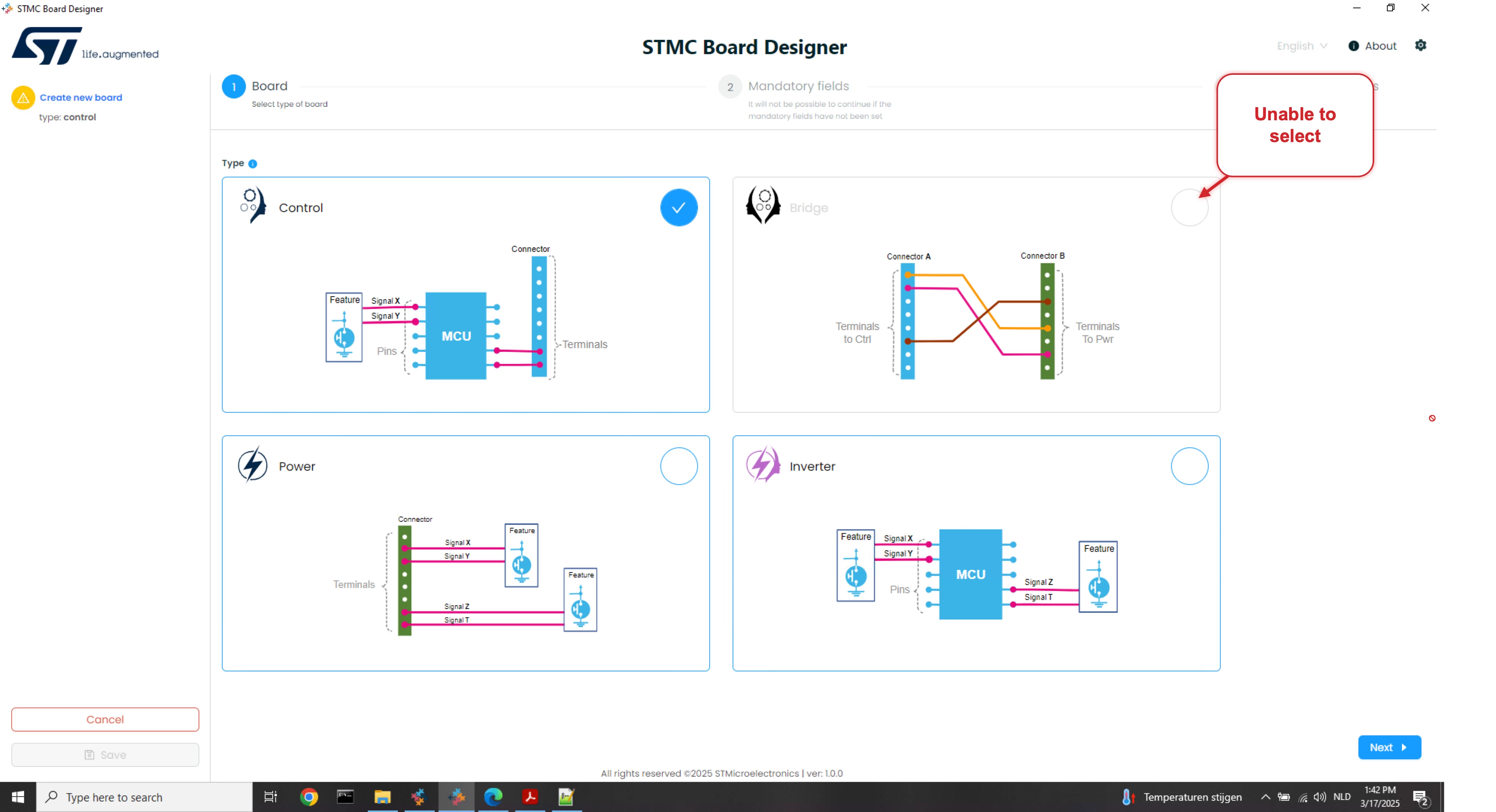

I'm currently using the STMC Board Designer but seem to be unable to create a "Bridge" board. I was hoping to use this to create a temp pinout into connecting 2 IHM08-M1 power boards to a Nucleo-H755ZI-Q evaluation board.
The documentation on the BRIDGE section isn't clear as well.
I tried adding a new board but am unable to select Bridge here:

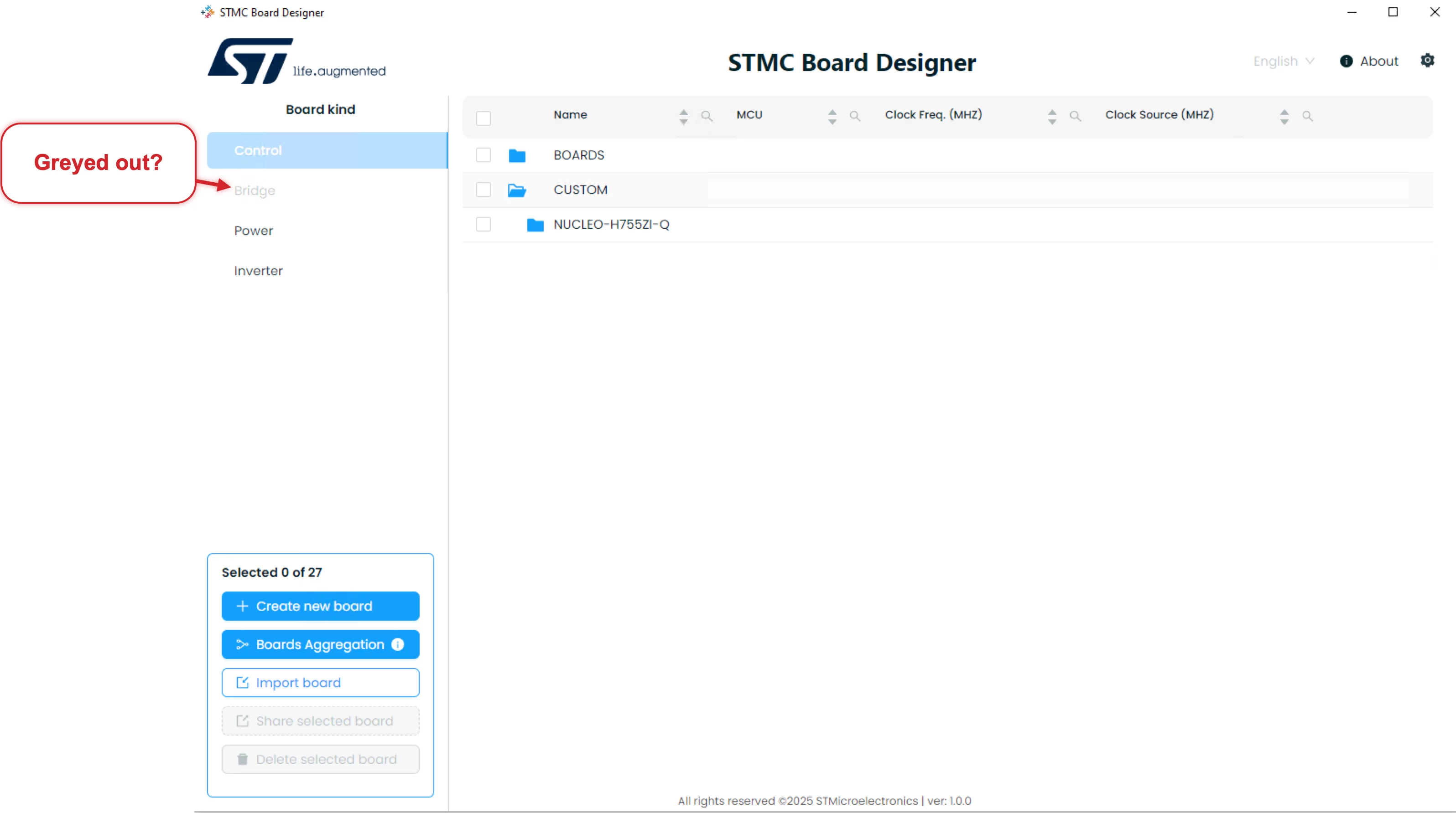

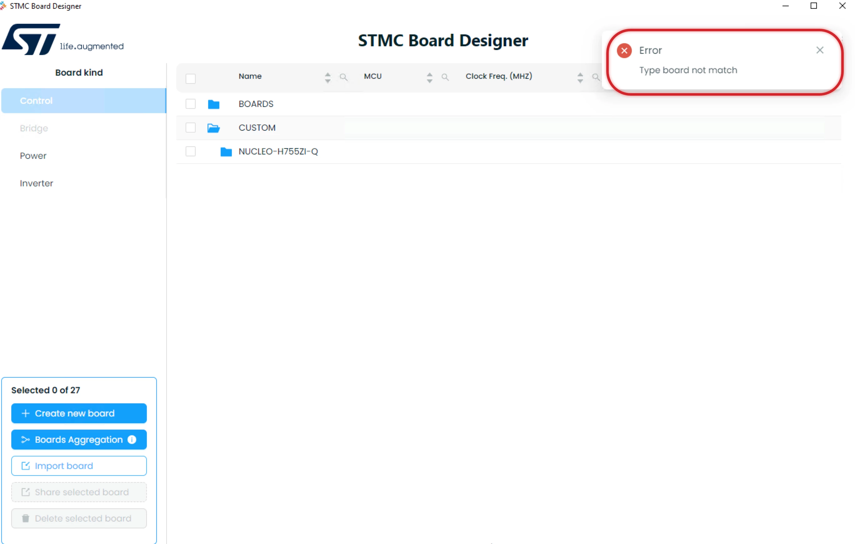

Then I tried creating a .json for a Bridge board but I'm unable to import it because I'm unable to select the bridge section.
Import failed due to "type board not match" which makes me assume that he's only able to import Control board since that tab is selected.
Could you guys help me out into creating a Bridge board?

Hello Zeno,
The Board Designer is currently unable to describe a Bridge board. There are however a few solutions to your problem :
- You can use the Board Manager to write your .json file. You will just need to import it inside the WB to be able to generate a project. This should work as long as you don't use the Board Designer.
- Using the Board Designer, you can create an Inverter Board that will behave as your 2 IHM08-M1 power boards and Nucleo-H755ZI-Q setup. As long as each feature is connected to the correct pin, you should have no issue.

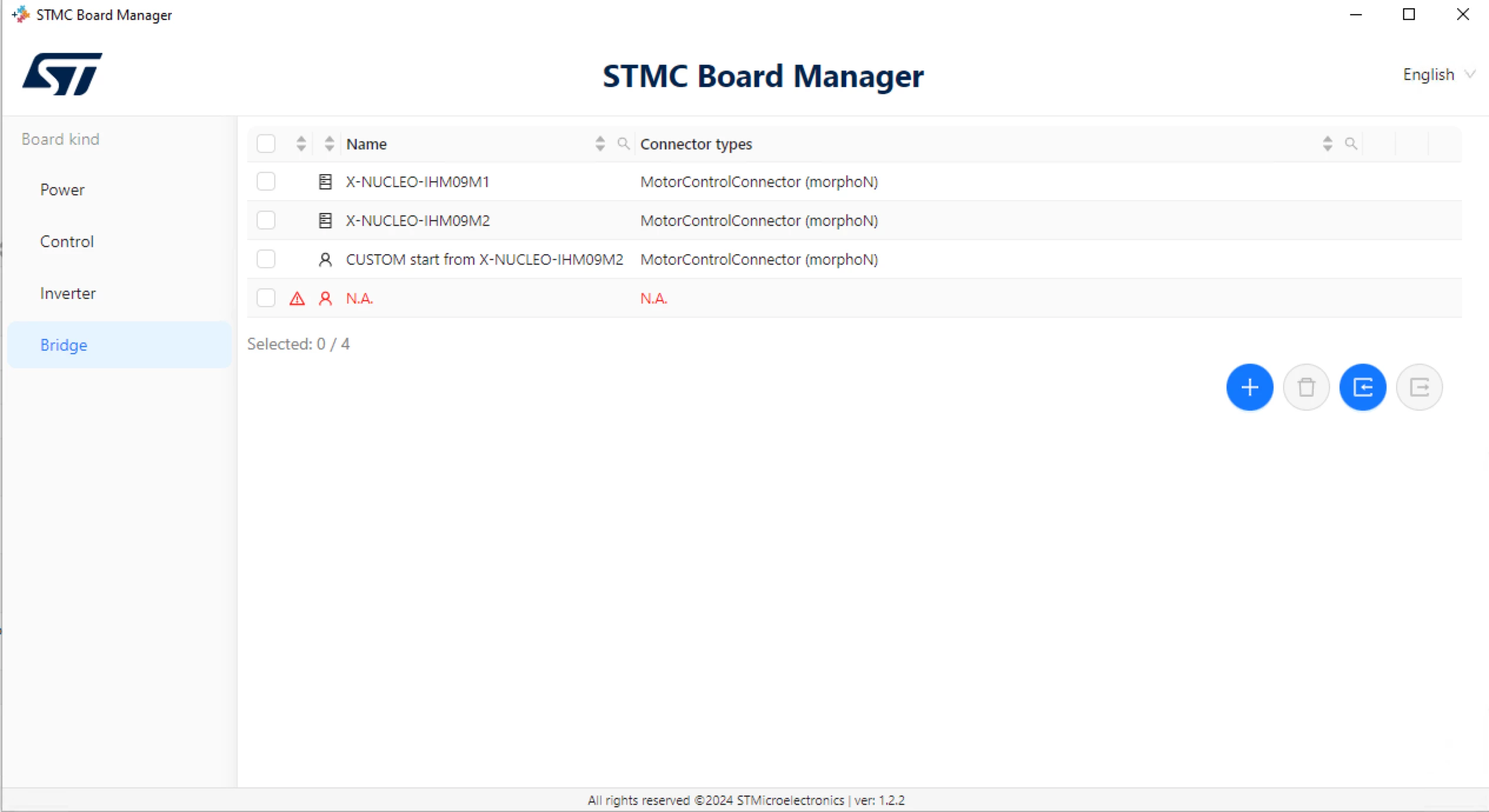

Update, using the STMC Board Manager I seem to be able to add a Bridge/Adapter.
However still unable to configure it using the STMC Board Designer.
