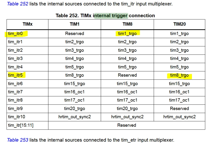

I am working on a motor control project that need to generate 3 sine waves with 120 degree phase shift to power a 3-phase AC motor. The target MCU is an STM32G483VET6 with 100 pins, and I though that for the first step  to generate 3 PWM with phase shift shouldn't be a problem with this MCU, but it is :)
Ok, so as stated in the reference manual, there are TIMx internal trigger connections, which I thought can be used for chaining 3 timers: TIM1, TIM8, TIM20 because they can generate complementary outputs as well:
According to Table 252, I should have easily set this up with MX. I started to process this table, TIM1 is the first timer which can trigger TIM8 through ITR0, and TIM8 can trigger TIM20 through ITR5.

The outcome is that TIM1 and TIM8 are basically the same, with just a few microseconds delay between each other:
TIM20 is 120 degree phase shifted from TIM8:
What am I doing wrong ?
Every idea is highly appreciated.

If your main point is to drive only one motor with three phases, you need only one timer. The 3 sine waves are generated thanks to the variation of the duty cycles of the channels CH1/CH1N, CH2/CH2N, CH3/CH3N. Those duty cycles are configured with the respective Capture and Compare registers respectively CCR1,CCR2,CCR3.

The original question's problem usually lies in incorrectly started slave timers. The point of slave-mode controller in Trigger mode is, that when trigger arrives, the TIMx_CR1.CEN bit is set, that's all. In other words, you are not supposed to set that bit "manually", and you are also not supposed to enable the master timer (set its TIMx_CR.CEN) before all slave timers are set up. A good way to check if this all is fulfilled is to set up everything except setting master timer's TIMx_CR.CEN, and at that point read out and check all timer's registers if they are set as expected.
When it comes to something which can't be get working simply by clicking in CubeMX, Cube usually gets more into way than helps, as the various Cube/HAL functions have intertwined behaviour and consequences of calling each function may not be fully inferred just from that function's name, and they don't map directly to functionality described in the RM.
You may want to explore the path Cedric outlined above, but IMO even then having an understanding how the hardware works makes life easier. Such understanding is achieved by writing a bunch of simple experimental programs working at the register level, or even just experimenting with the timers' registers in debugger, and observing the resulting behaviour.

I finally solved it with a help of this thread, and with your suggestions.
Thank you very much.
Jony404AuthorBest answer
November 14, 2023
Oh, I forget to post the solution for the problem:
 /* USER CODE BEGIN 2 */
 htim20.Instance->CCER |= (TIM_CCx_ENABLE << TIM_CHANNEL_1);
 htim20.Instance->CCER |= (TIM_CCx_ENABLE << 0x02);			// complementary channel
 htim20.Instance->BDTR |= (TIM_BDTR_MOE); // set outputs
 htim20.Instance->CR1 &= ~(TIM_CR1_CEN); // disable timer
 htim20.Instance->CNT = 0; // reset timer
 htim8.Instance->CCER |= (TIM_CCx_ENABLE << TIM_CHANNEL_1);
 htim8.Instance->CCER |= (TIM_CCx_ENABLE << 0x02);			// complementary channel
 htim8.Instance->CCER |= (TIM_CCx_ENABLE << 0x04);			// Compare on Channel 2 output
 htim8.Instance->BDTR |= (TIM_BDTR_MOE); // set outputs
 htim8.Instance->CR1 &= ~(TIM_CR1_CEN); // disable timer
 htim8.Instance->CNT = 0; // reset timer
 htim1.Instance->CCER |= (TIM_CCx_ENABLE << TIM_CHANNEL_1);
 htim1.Instance->CCER |= (TIM_CCx_ENABLE << 0x02);			// complementary channel
 htim1.Instance->CCER |= (TIM_CCx_ENABLE << 0x04);			// Compare on Channel 2 output
 htim1.Instance->BDTR |= (TIM_BDTR_MOE); // set outputs
 htim1.Instance->CR1 &= ~(TIM_CR1_CEN); // disable timer
 htim1.Instance->CNT = 0; // reset timer
 htim1.Instance->CR1 |= (TIM_CR1_CEN); // enable timer
