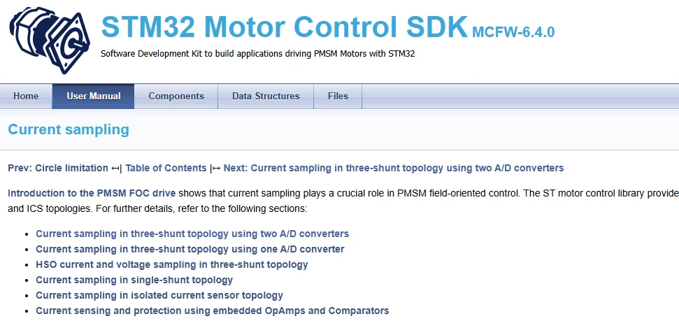

Hello ST Community,
I am designing a FOC motor controller using STM32G4 and want to use 3 separate ADCs (ADC1, ADC2, ADC3) in injected mode for simultaneous 3-phase current sampling.
I know that some microcontrollers have triple-mode ADCs, which allow all three ADCs to start and finish simultaneously. My question is:
1. When TIM1_TRGO is triggered, do all three ADCs start converting simultaneously, or is there a sequential order (ADC1→ADC2→ADC3)?
2. What is the safest way to read an ADC for FOC algorithm?
I am very new to this field, so please excuse me.
Best regards
STuser2Best answer
Senior III
August 20, 2025
The phase current sensing is described in the MCSDK 6.4.0 user manual
According to me 2 ADC channels are read simultaneously for 2 phase currents and the 3rd one is derived, which 2 phase currents to be read depends on the duty of the PWM.
