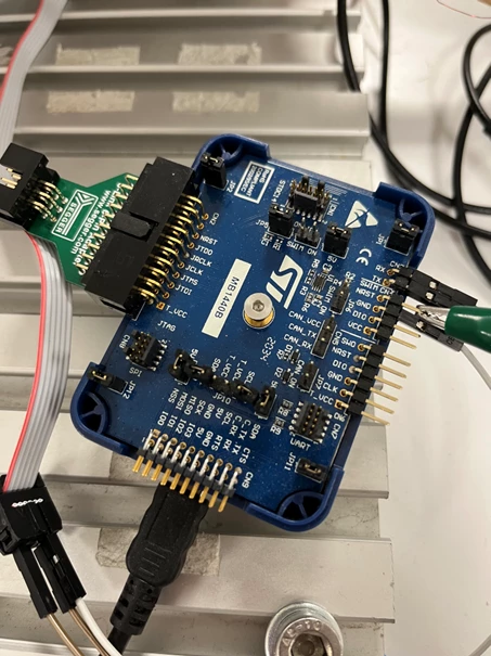

HI,
Could you describe me your ST-Link setup please? Is it a version 2 or version 3? Is it external or integrated on your board? How is it connected to the STM32 target?
Could you send me the reference of your USB isolator?

Hello and thanks for you answer. The ST-link is external and is a V3, connected to the target via a ARM20-CTX 20-Pin to TC2030-IDC Adapter and a segger TC2030 cable.0693W00000WLA0pQAH.pngI already ruled out a possibly bad connection by soldering the wires directly to the target - no change.

December 16, 2022
Could you reduce the wire length between ST-link UART and your board? I see some wire connect to another cable. You cannot achieve a stable communication @1.8Mbaud which such long wire. Please don't exceed few centimeters. ( I have faced issue with 10 cm).
Or reduce baudrate...

December 16, 2022
thank you, I reduced the wire length to the minimum for me possible, about 3 cm. Still no improvement unfortunately. I reduced the baudrate to 115200 in combination with the short wires, now its a bit better with less often connection cuts, but still far away from stable.

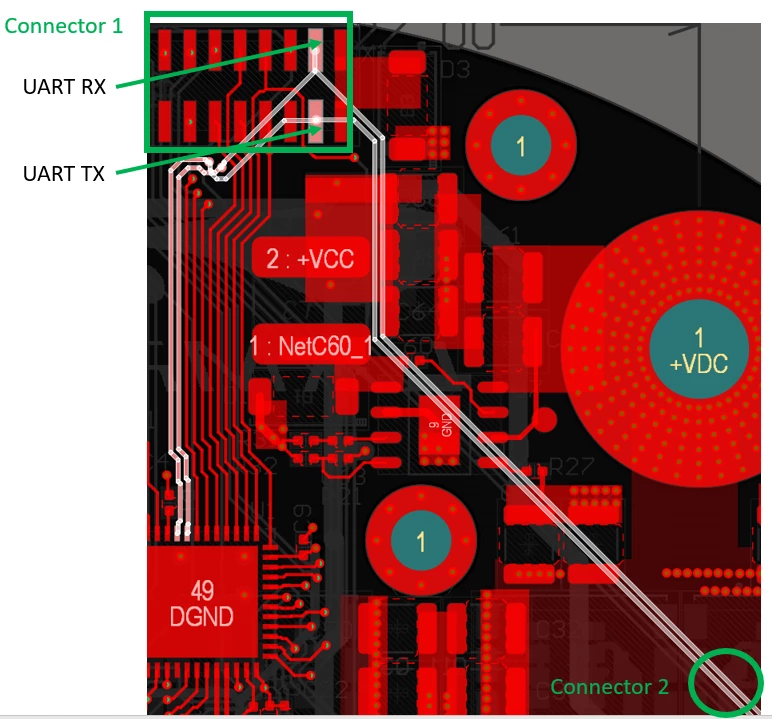

ALedi.1Author
January 11, 2023
the routes for UART go from the µC to a first connector and from there to a second connector, the UART routes to the second connector are normally only used for flashing the device, while the UART connection to the first connector are used for communication with motor pilot during operation.
0693W00000Y7w1CQAR.pngthe the traces are routed on 2 different layers L1 & L2, L1 is the red layer shown, L2 has only signals on it, no power lines. No shielding is used. The Power MOSFETs are on layer 6, with a ground layer on layer 4.
January 23, 2023
Could you make a trial of cutting trace going to connector 2 close to connector 1 and to connect the uart on connector 1 with short wire?
Could you also indicate me what is your clock source and her value? What are your settings of clocking in firmware? (Do you use CubeMx? if yes could you share an ioc file from Cubemx?)
