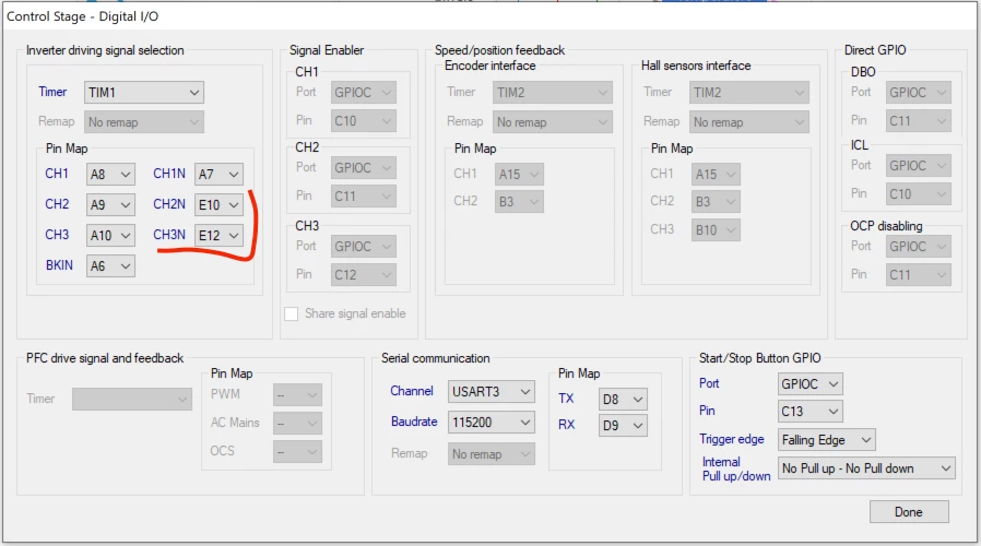

STM32F746ZG + IHM08M1 not all PWM Channels are used but motor still spinning.
Hi!
I am using STM32F746ZG + IHM08M1, I removed all bridges as recommended in Motor Profiler tool, and then I generated a project with Workbech. What I spotted that motor spins not that smooth like with F3 or F4 series.
While testing I found that only CH1, CH3, CH1N channels are used to spinn the motor.
CH2N, CH3N are assigned to pins PE10, PE12 that are not even connected to the IHM08M1.
When I reassign them correctly the motor stops working.
I wanted to use other power board, based on the configuration and code. But now I am not sure how does this work.
Can some one explain why this F746 board is so strangely configured?

Hello @VKost.2​,
in the Motor Profiler tool the configuration for X-NUCLEO-IHM08M1 board is available if used only with NUCLEO-F303RE or NUCLEO-F302R8.
If you use a different control board - with STM32F746ZG - you cannot correctly drive the Power board.
[Edit: in my previous tests I was using an old version of Motor Profiler (5.4.3) where the board NUCLEO-F746ZG was not yet present].
If you want to test the X-NUCLEO-IHM08M1I suggest to use a control board compliant with ST tools.
For instance if you want to uso the dedicated X-CUBE-SPN8 software expansion for STM32Cube you can choose among NUCLEO-F302R8 or NUCLEO-F401RE.
Let me know if I answered to your doubts.
