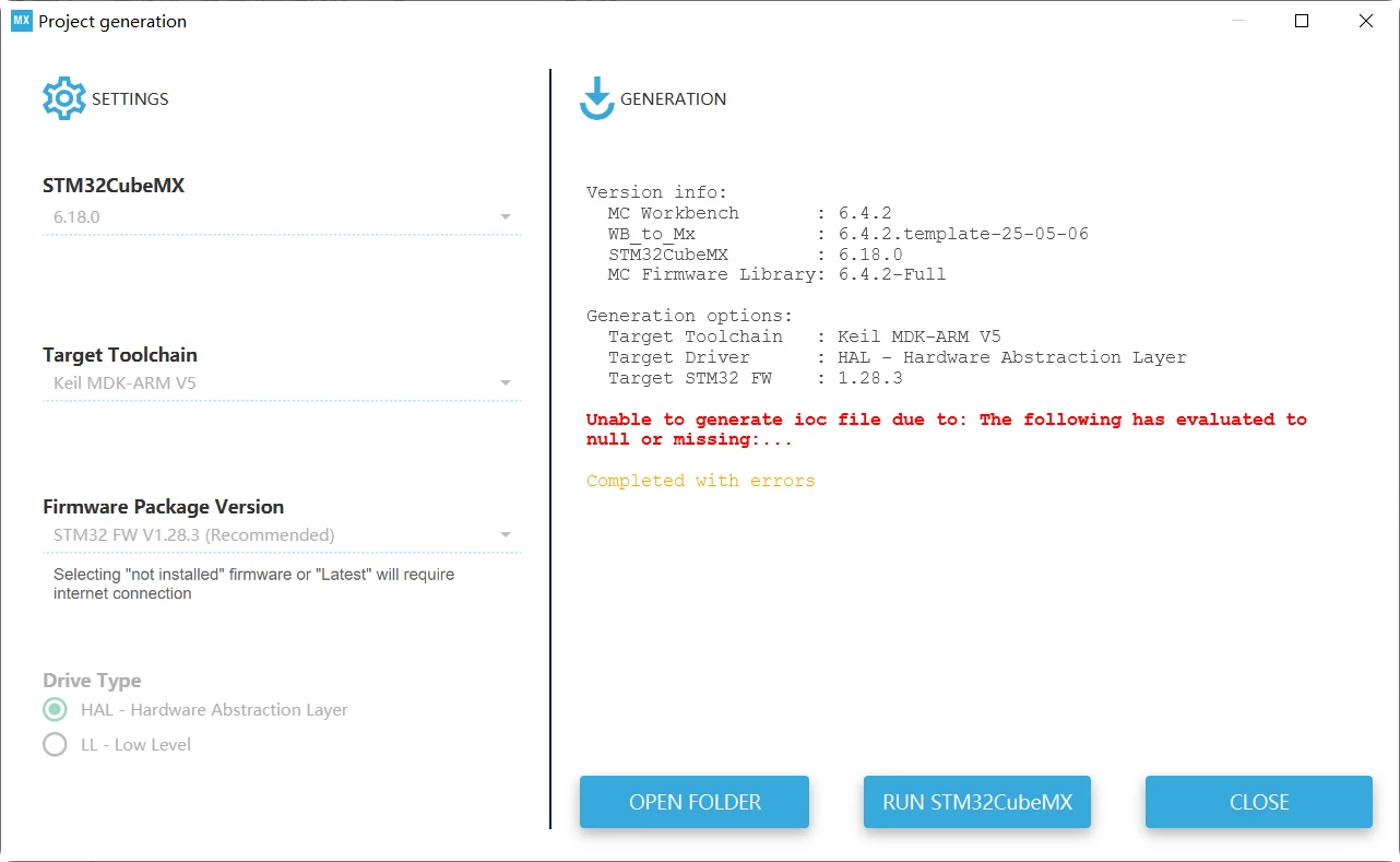

Jul 17, 2026 1:06 AM UTC
Hello, I have copied the attached STM32F405RGTx.json microcontroller (MCU) description file to ~\.st_workbench\hardware\mcu. I also created a new inverter project using MotorControl Workbench 6.4.2, yet the code generation failed as shown in the figure below. Looking forward to your reply.

GMA
Jul 22, 2026 2:19 PM UTC
Hello ​@PANDI902,
Unfortunately, for the STM32F4 series, adding the microcontroller (MCU) description file is not sufficient. Another method can generate a motor control project for an unsupported MCU. In the MC Workbench tool, generate a project for the supported NUCLEO-F401RE control board.
In the STM32CubeMX tool, perform the following steps:
  1. Create a new project with STM32F405RG.
  2. On the File menu, select Import Project, and then load the NUCLEO-F401RE .ioc file.
  3. Save the project.
Copy the NUCLEO-F401RE project ftl directory to the STM32F405RG project folder. In the STM32CubeMX tool, generate code for STM32F405RG. Adapt the generated project to the target configuration.

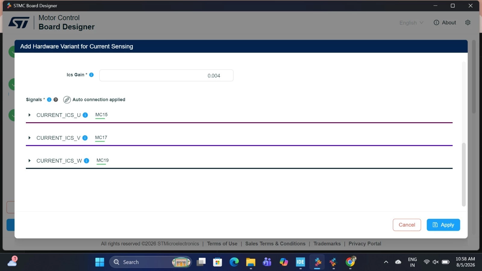

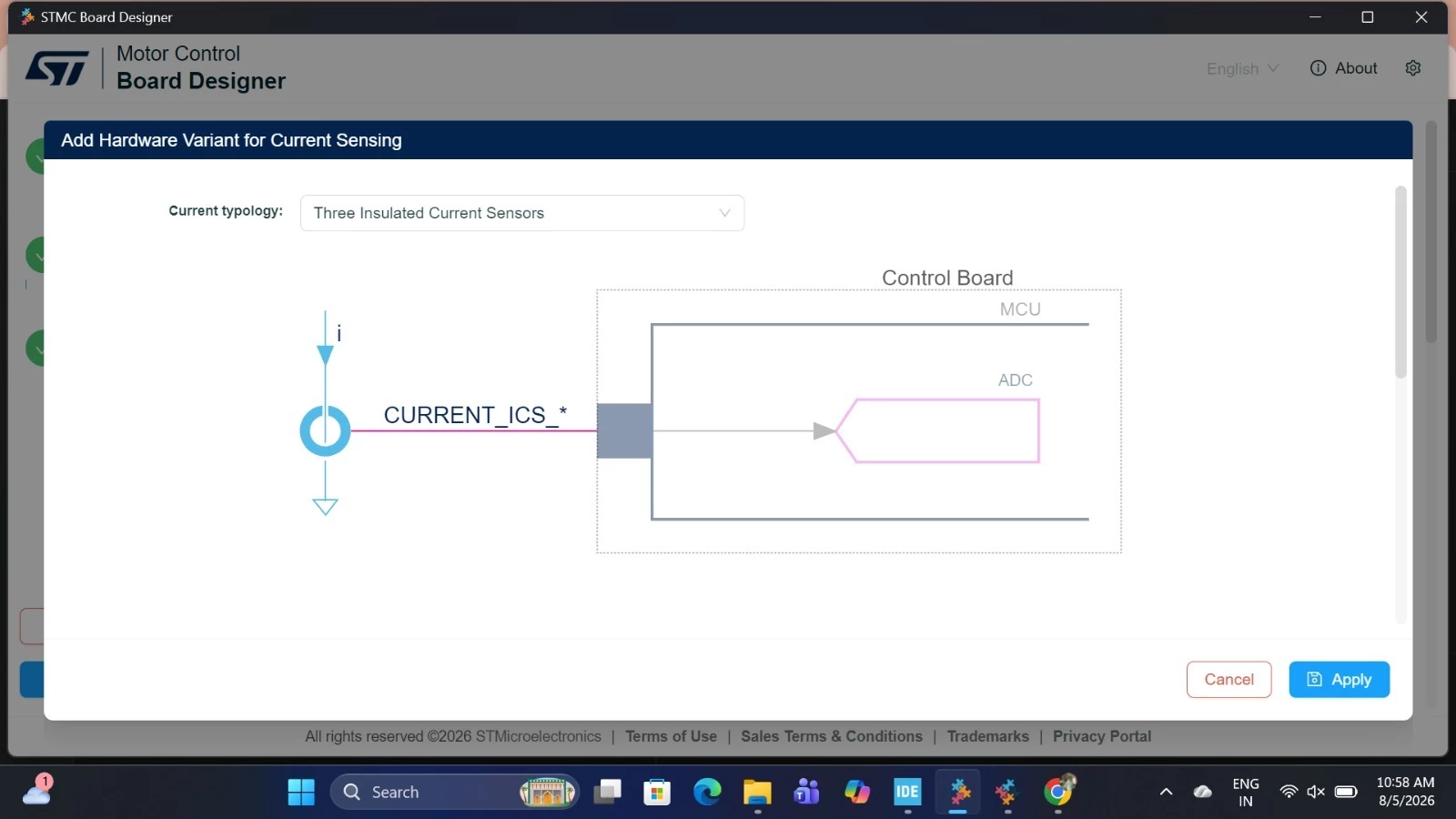

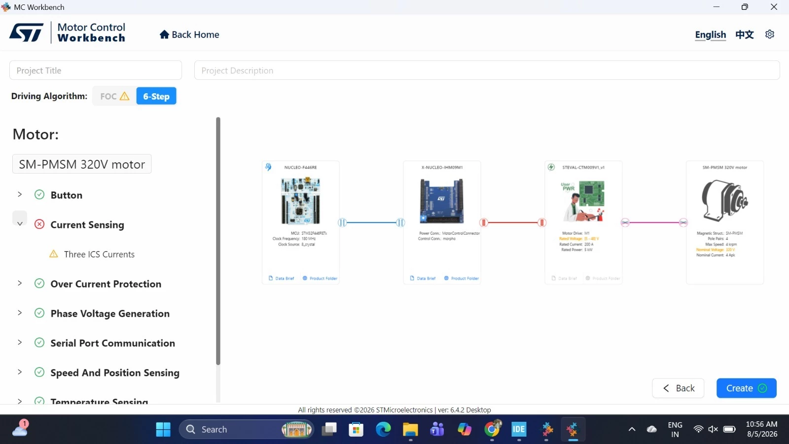

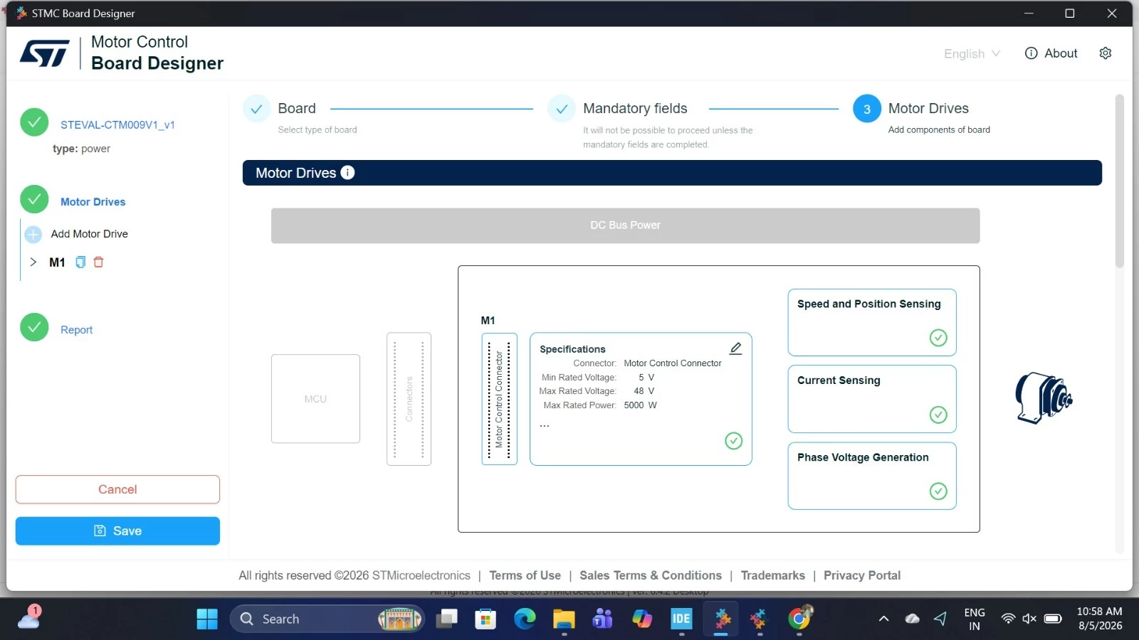

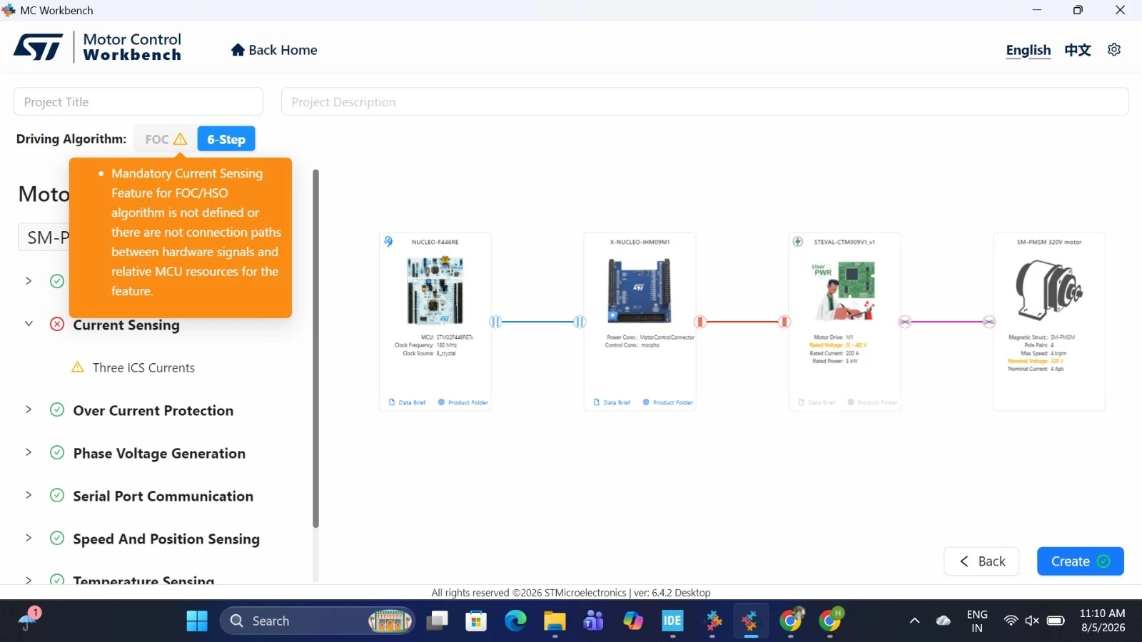

PANDI902Author
Aug 5, 2026 5:45 AM UTC
Hi GMA,
Using NUCLEO-F446RE + X-NUCLEO-IHM09M1 + STEVAL-CTM009V1 in MC Workbench (FOC).
With the default Two Insulated Current Sensors variant, everything validates fine — no errors, Create works.
When I clone the board and switch Current Sensing to Three Insulated Current Sensors instead (CURRENT_ICS_U/V/W auto-map to MC15/MC17/MC19, applies cleanly in Board Designer with a green checkmark), MC Workbench then shows a red ✕ on Current Sensing with this error:
"Mandatory Current Sensing Feature for FOC/HSO algorithm is not defined or there are not connection paths between hardware signals and relative MCU resources for the feature."
Is 3-ICS actually supported with the IHM09M1 bridge for this power board, or is 2-ICS the only validated option? Screenshots attached.
Looking forward to your guidance.
