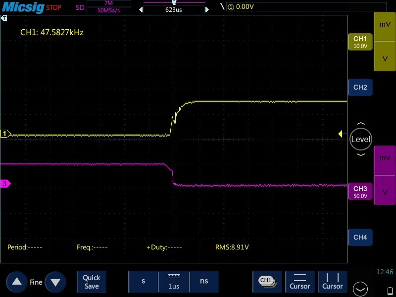

The problem is with the complementary outputs.
For example, when monitoring PA8 (CH1) and PB13 (CH1N) on an oscilloscope:
• When PA8 is HIGH, PB13 is LOW.
• When PA8 goes LOW, PB13 goes HIGH.
• However, I am not consistently able to observe the expected 500 ns
  dead-time interval at every transition.
• Some transitions appear to have the expected dead time, while other
  transitions appear different.

>1. Is DeadTime = 24 correct
ok, at 48M, CKD = 0 , 24 x 20.8 ns = 499 ns
>3. Is PWM Mode 1
is what you want - ok.
>4. Is there any additional TIM1
seems ok
>5 recommended configuration
you have to know, what you want
>6 Could there be ...   issue causing the observed waveform
The waveform looks ok for me, just your measurement is not ok: unloaded output...gives a mix of switching and charged voltage; check your TIM signals at the cpu pins (and scope probe calibrated for square wave and 10:1 setting);
then you will see exactly 500ns dead times.

AScha.3

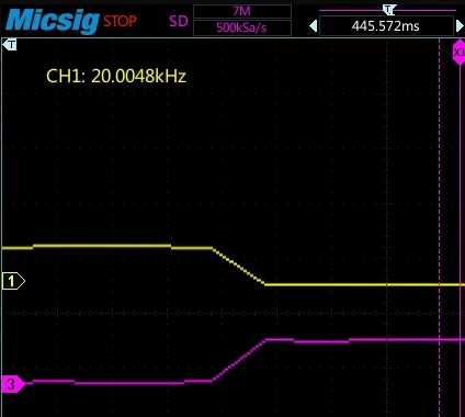

>I will repeat the measurement at the CPU pins and verify whether I can observe the expected ~500 ns dead time.
I am still waiting for a useful measurement.
This :
..is just a joke. At 500ks (= 2 us sampling steps)  to “prove” a delay in the xx - ns range is just nonsense.
Do a meaningful measurement .
Or ask for help, how to setup a scope and learn, how to do it.

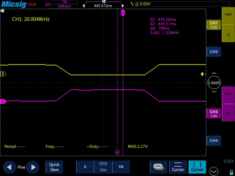

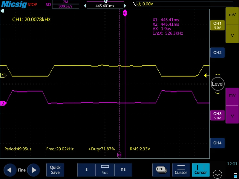

PANDI902Author
We are also expecting the same result. Even after performing the dead-time calculation correctly and applying the calculated value, we are still not able to observe the expected 500 ns dead time in the waveform.
Regarding the oscilloscope measurement, we understand and are already familiar with using the oscilloscope, probe calibration, 10:1 probe setting, and cursor measurements.
However, our main concern is this: if the dead-time interval is not clearly visible in the waveform, how can we accurately place the oscilloscope cursors at the beginning and end of the dead-time period?

Andrew Neil
As ​@AScha.3 said, you cannot expect to accurately capture something on the order of 500 nanoseconds when your sampling interval is only 2 microseconds !

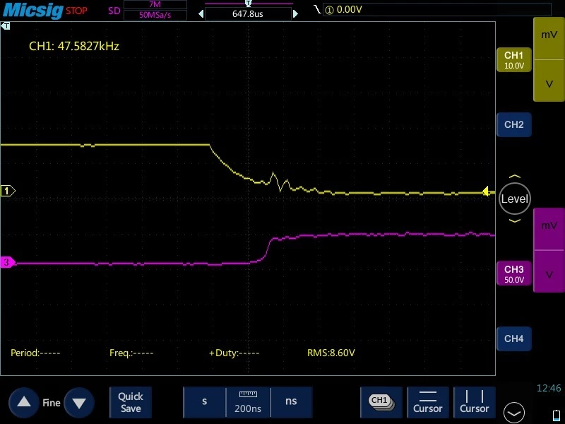

AScha.3
This is about : how to set your scope/DSO , not about the cpu or the TIM output.
In your first pics there was a better setting of your DSO: (50MS/s , about 20ns resolution possible)
So try to capture a more useful shot , maybe use single shot mode and appropriate horiz./time setting, maybe 2us/div .
Then show pic/result with the 2 channels, triggered on 1.
btw the micsig is this: ?  (max. 1 GS/s ! )
