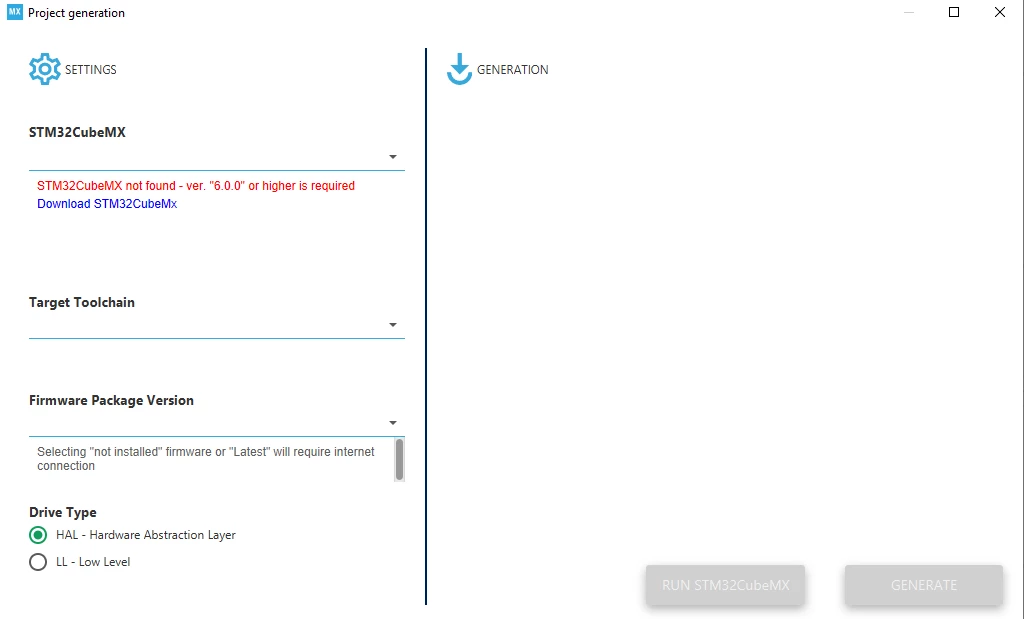

I saw that some people had a similar problem to mine. When generating the project on MC Workbench I have the following error: STM32CubeMX not found - ver. "6.0.0" or higher is required
But I have STM32CubeMX installed with version 6.14.0
I tried to install STM32CubeMX for all users or to change the Windows language to English as I saw on other posts but without success.
Does anyone have another suggestion?
Here are some various screenshots that have been asked in similar posts
Thanks for your help !

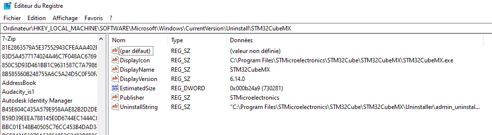

- Can you verify if the executable exists in the relative path as for the image shared? C:\Program Files\STMicroelectronics\STM32Cube\STMCubeMX\STMCubeMX.exe (in your case, please check also the upper /lower case characters in the full file name path)
- Can you run the following command at terminal and share the test.log generated?
REG QUERY HKEY_LOCAL_MACHINE\SOFTWARE\Microsoft\Windows\CurrentVersion\Uninstall\STM32CubeMX /reg:64 > test.log
if your operative system is 32bits the above option should be /reg:32

- Can you verify if the executable exists in the relative path as for the image shared? C:\Program Files\STMicroelectronics\STM32Cube\STM32CubeMX\STM32CubeMX.exe (in your case, please check also the upper /lower case characters in the full file name path) Yes it exists, and it is the same path : C:\Program Files\STMicroelectronics\STM32Cube\STM32CubeMX\STM32CubeMX.exe
- Can you run the following command at terminal and share the test.log generated? If I don't run the command in admin mode it doesn't work. Here is the result in admin mode :
UninstallString REG_SZ "C:\Program Files\STMicroelectronics\STM32Cube\STM32CubeMX\Uninstaller\admin_uninstall.bat"
DisplayName REG_SZ STM32CubeMX
DisplayIcon REG_SZ C:\Program Files\STMicroelectronics\STM32Cube\STM32CubeMX\STM32CubeMX.exe
DisplayVersion REG_SZ 6.14.0
Publisher REG_SZ STMicroelectronics
EstimatedSize REG_DWORD 0xb24a9

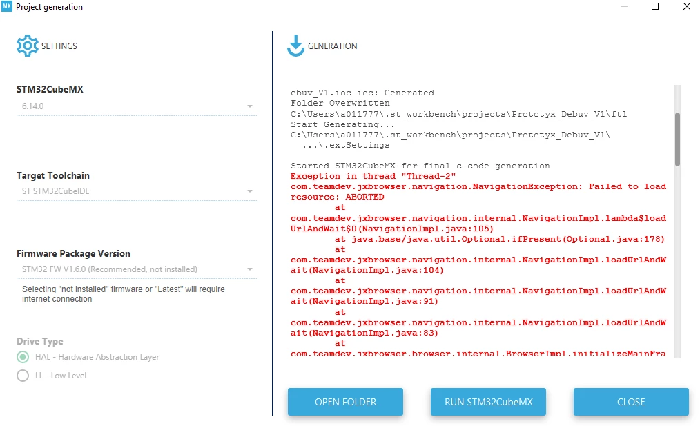

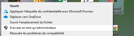

After some testing this morning, MC Workbench is able to find STM32CubeMX when it is launched in admin mode
But there are lot of issues,for example Board Designer and Board Manager doesn't work and I have the following error when I generate my project :

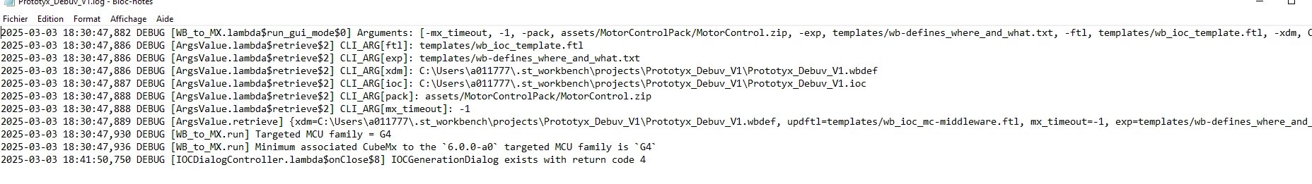

Attached is the full log. Hope this can help.

Sometime after the installation of a new CubeMX (admin or user) it needs to run the first time the CubeMX as stand-alone application to work properly with Workbench.

The image you are sharing is from MC Workbench and the log inside is the one coming from CubeMX, in case of project code generation there is not interaction with Board Designer or Board Manager. You can open the relative .ioc file directly from your CubeMX application and generate the code from there.

I have the same problem as @Xavier75. that MotorControl Workbench states "STM32CubeMX not found - ver. "6.0.0" or higher is required"
I see that on "administrator" account, when I start MotorControl Workbench 6.4.1 I can "see" STM32CubeMX v 6.16.0, but on my local account it cannot - regardless STM32Cube is installed in local account or administrator account to be used by all users.

Try to run the first time the CubeMx from your account and verify that it works, then run Workbench and generate.
Please note that, after the installation could be useful to restart.
