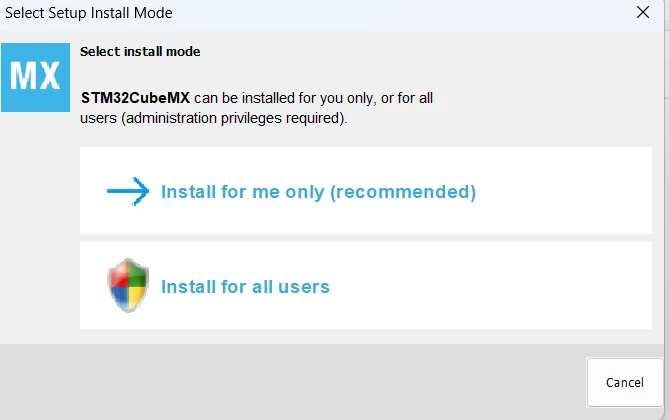

STM32CubeMX not found - ver. "6.0.0" or higher is required-SOLVED
I have been getting an error while using MC Workbench to drive ihm03 motor and motor driver package,
i haven't satisfied by the answers in forum so i solved it in a different way.

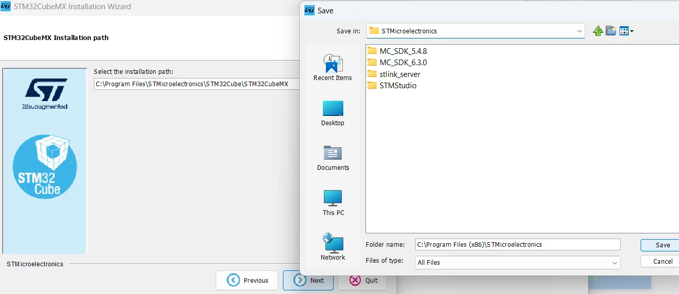

At first in installation phase (while setting up STM32CubeMX), i was chosing "Install for me only (recommended)" option for installation mode therefore MCSDK was not to be able to see it from its path.
To solve my problem i decided to choose "Install for all users" option. Then now i can generate code in MCSDK.

Hello tarikkutay,
Can please tell us in which mode you have installed the MCSDK ?
Thanks
Amina
If you agree with my answer, please accept it by clicking on 'Accept as solution'.
July 18, 2024
Sure Amina,
I have had clicked "Install for anyone using this computer" in MCSDK installer setup.
